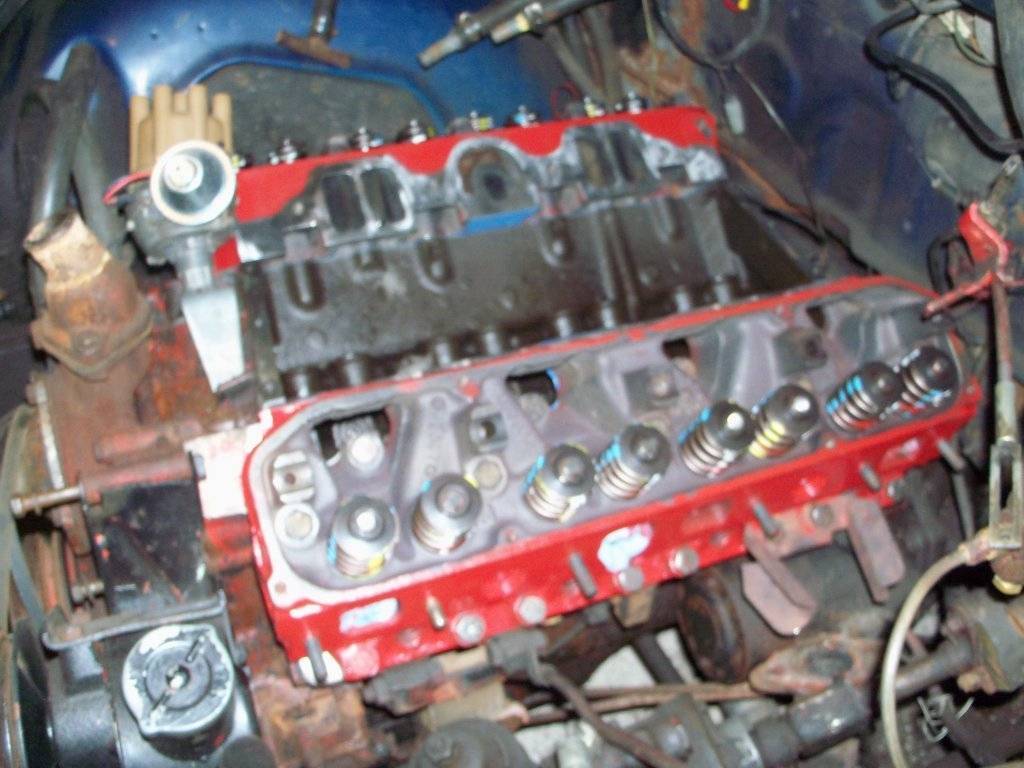

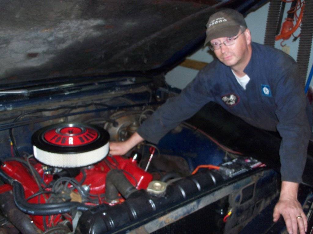

Dude,the 906 heads will be perfect for the combo you already have.
The engine will be much happier now it can breathe.
The 516 heads worked fine but were restrictive in the flow department.
I putt 452 heads on a 66 383 which are essentially the same as 906 heads with hardened valve seats.
Make sure you block off the heat crossover ports from the intake. A cooler denser fuel charge helps.
