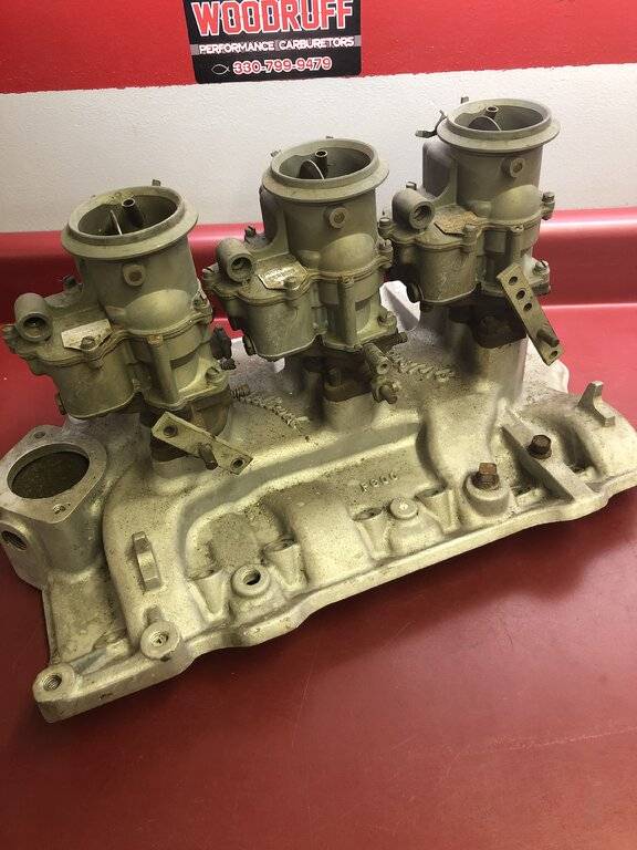

Now I don’t know what the heck to do. A guy just walked through the door and sold me this “poly” setup. I guess try them and see what it likes!?

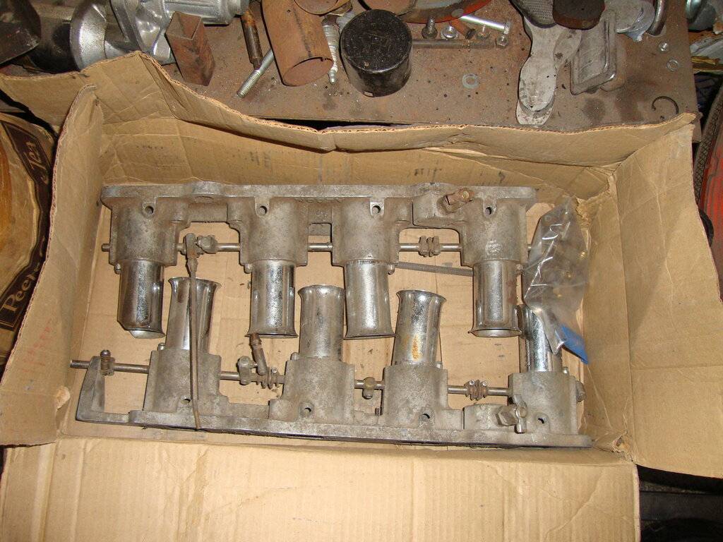

cool old setup , 94's are holley inside . same as ford flatheads in the fifties . i like if you want to sell pm me . this algon injection for an early chrysler hemi walked in to my shop one day .

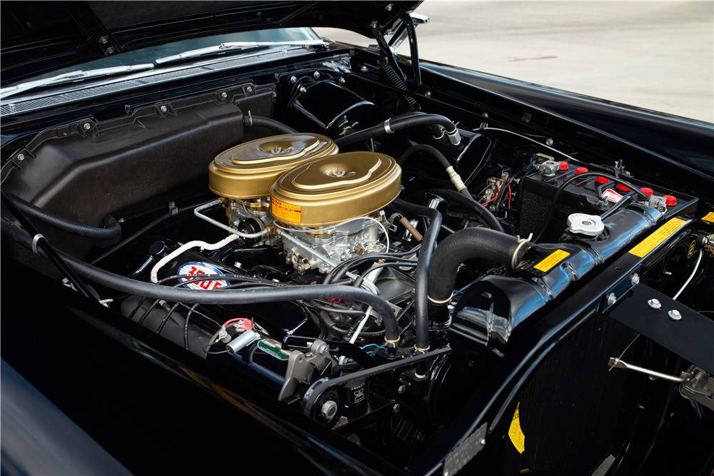

The carbs appear to be Carter WCFBs used on the Chrysler 300Cs and Ds at least but the air cleaners appear to be from an inline setup from a Chrysler 300 E that used Carter AFBs - but maybe those air cleaners were used on some cars before 1959..............
300E:

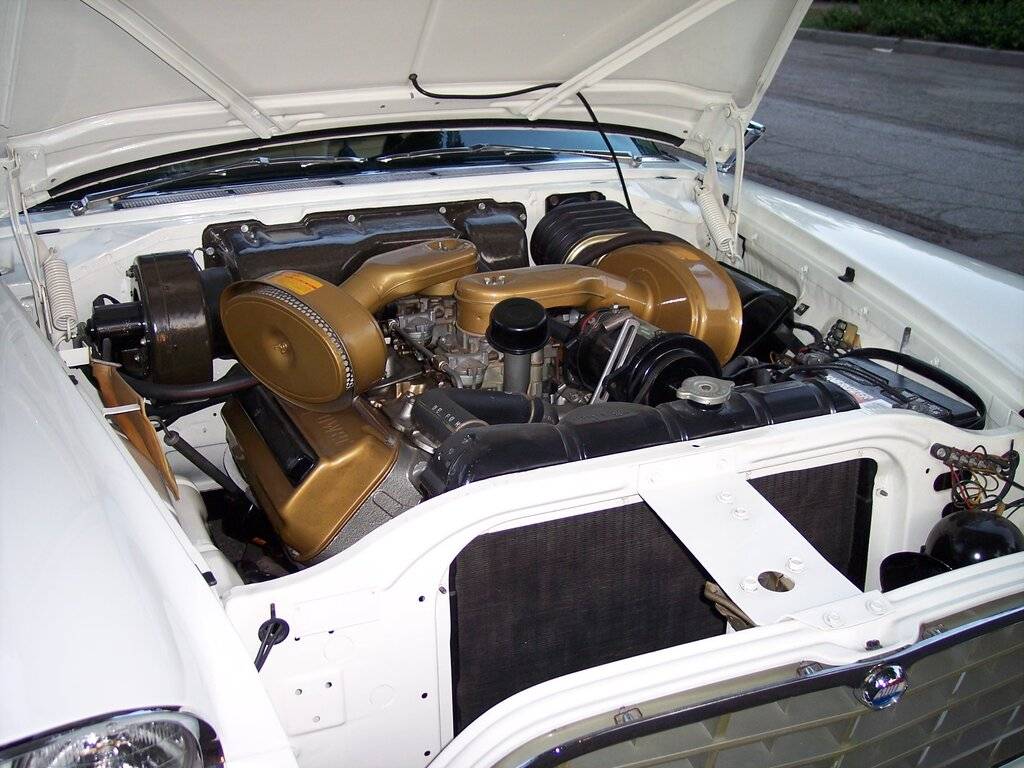

300C:

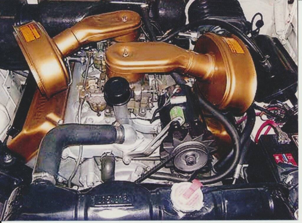

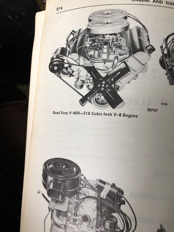

The carbs are the correct ones for 57 fury power pak. The jury is still out on the air cleaners.

That style air cleaner first came out for the '58-'62 2X4V carbs on in-line manifolds (not the ram-induction versions of the '60s) in '58 Plymouths, Dodges, DeSotos, and Chryslers. They were later found on '59 Dodges, DeSotos, and Chryslers but didn't appear again in production optioned engines until the '62 300H. Reproduction versions are available nowadays at $675 a pair. In the 1957 model year, dual-four engines (i.e., 318 325, 341, 354, and 392) used the "saddle bag" type like those on my 300C.

This is my 1957-58 FSM. This poly clearly has WCFB carbs.
