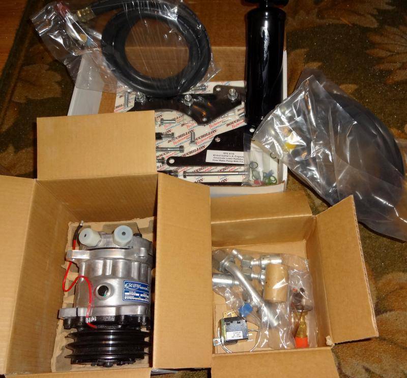

My Vintage air compressor conversion kit for the Admiral came today. We'll see how this go's.

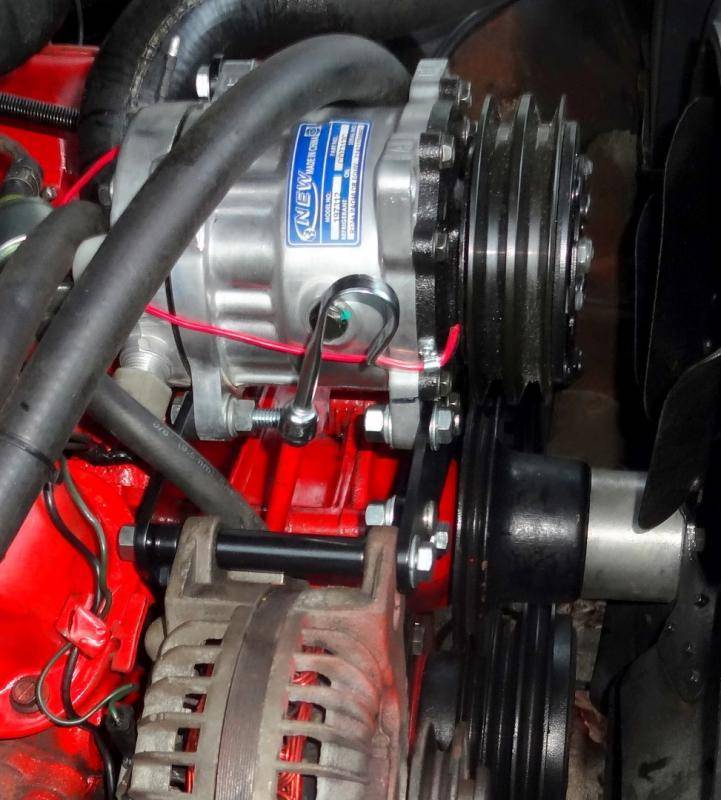

I'll get the new belts tomorrow, alignment looks good. The compressor bracket kit is well made and fit perfect. They could use a good service writer for their instructions though. Lucky the pictures were good.

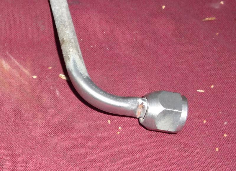

I also found a kinked line at the receiver dryer that I will have to replace, A trip to the salvage yard might yield one of those.

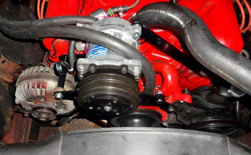

Pictures so far.

Hopefully there is someone nearby that can fabricate a new line for you. If the junkyard doesn't work out and you can't find it elsewhere... the truck parts stores usually can refer you to who helps them out with odd hoses and lines... I have been amazed at how often the truck guys have answers us car guys didn't know how to find.

Most hydraulics shops can fab one for you in less than 24 hours. If you can't find one Benz Hydraulics in Bear, Delaware will make one for you.
Thanks guys. Most any A/C equipped Mopar from the era used the same line. I know of several in nearby salvage yards. It gives me a good reason to go visit them, (not that I need a reason).

I did a similar conversion to my Polara about 6-8 years ago using the Classic Auto Air bracket kit and Sanden compressor. R134a, did *not* change the condensor, and it works great. You'll be happy! I do recommend getting some AC flush solvent and thoroughly flushing the evaporator and condensor then blasting them out with compressed air.
