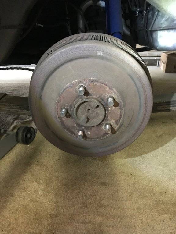

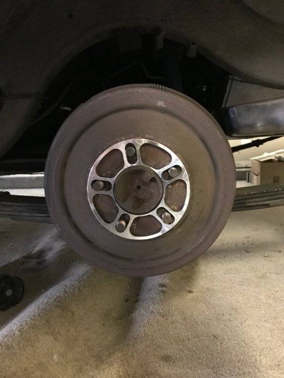

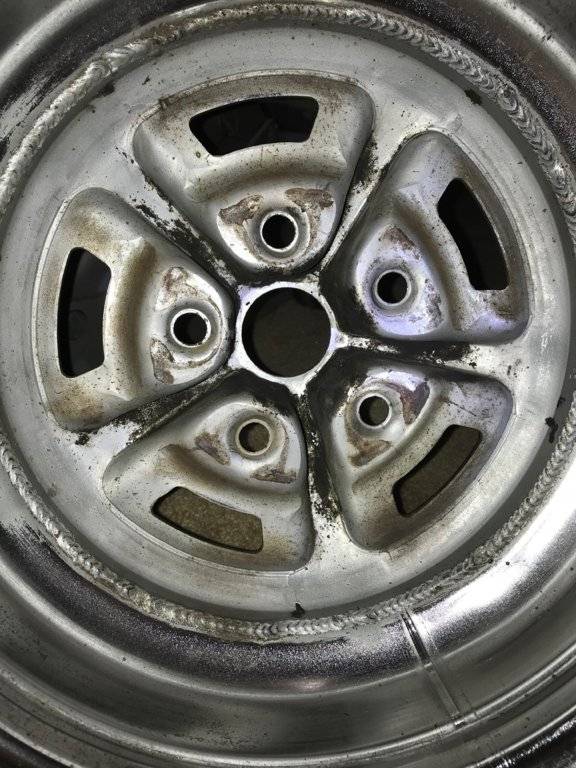

But then reality set in... you know the saying saying of "if it's too good to be true, it probably is"? I think that might be the case with these wheels. It looks like the center hub at the rear drum is just ever so slightly larger that the seating surface on the inside of the wheel...like maybe only 1/16th of an inch wider. I am still holding out hope that there may be a solution to be able to use these wheel, but my mind is blank on where to go with this.
Is it possible that there could be some type of spacer out there that fits between the back side of he wheel and the surface of the hub on the drum? Could I get away with just slipping a washer over each stud that matches the height of the center hub (this level of car knowledge is a bit outside my wheelhouse)?

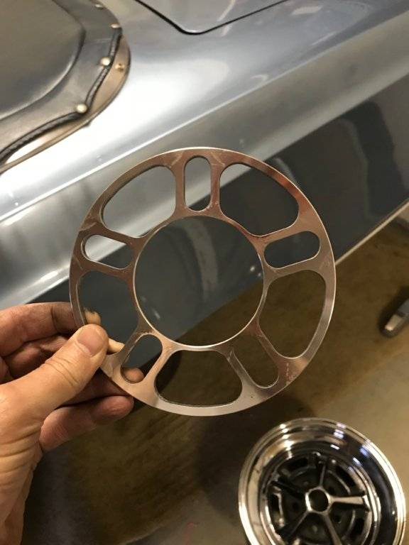

They make wheel spacers just for this type of situation. You DO NOT want to use washers on the wheel studs.
So the local parts store didn't have the spacers. Hopped on to Amazon, and to my surprise....Same Day Delivery! On my doorstep by 5PM, on a Sunday!!!

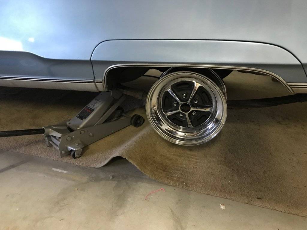

Jacked up the car and gave the rims a test fit... I got me some winners here.
These will be headed to the wheel straightener this week (one of the exterior beads is slightly bent). I am going to work with my daughter on reconditioning the black painted sections, then get the existing tires mounted up. Very exiting.
