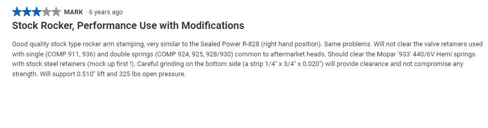

also does anyone know if the stock rocker will contact after market retainers like the ones above?
I was looking at roller rockers but I want to keep my stock covers and this kind of scared me off
