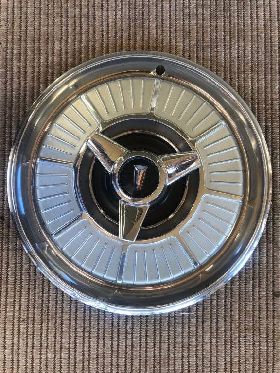

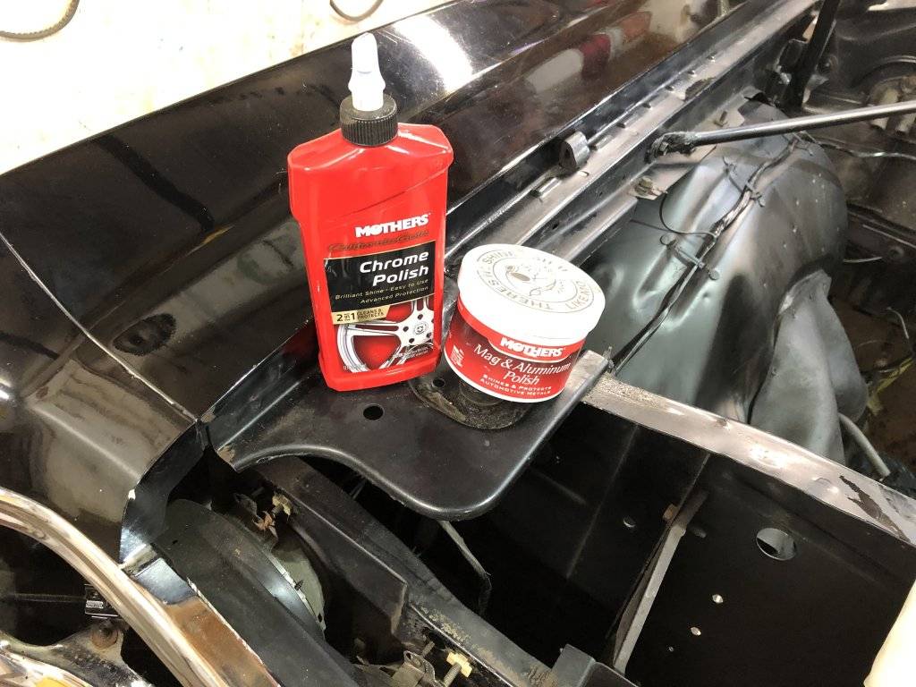

Elbow Grease! Know what you mean; dismantle, clean, paint insignia with Testor's and tooth pick, tape and spray with Argent Silver paint, reassemble; 6 hours per hubcap, two beers and 45 minutes while admiring and praising myself (repeat often) and then 15 minutes to brag to neighbor!000 steel wool. Glass cleaner to start with. Semi gloss rustoleum paint thinned down just a little. Then mostly elbow grease
Looks awesome!Elbow Grease! Know what you mean; dismantle, clean, paint insignia with Testor's and tooth pick, tape and spray with Argent Silver paint, reassemble; 6 hours per hubcap, two beers and 45 minutes while admiring and praising myself (repeat often) and then 15 minutes to brag to neighbor!
