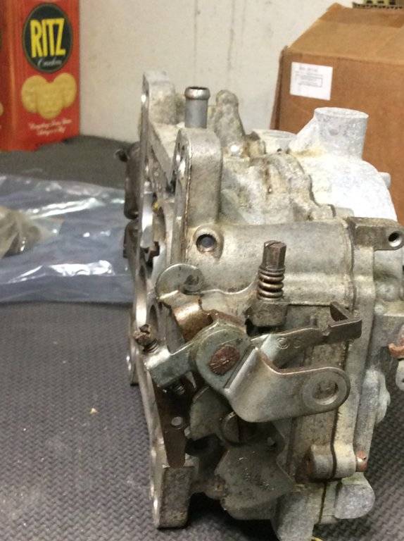

Willis, your point well taken... the accelerator pump nozzles squirt fuel, so there was fuel in the carburetor when I've checked that function.
Something of note** Last week, after getting the car started and warmed up, I drove to a gas station about 1/2 mile away. I turned the car off, opened the hood, and noticed a small, wet fuel puddle the size of a half-dollar on the intake near the right, front corner of the carb, about where the accelerator pump is.. I didn't see any dripping, and eventually it evaporated. As I drove around a bit during the next hour, I stopped periodically to check the carb and mani for fuel leaking and saw none. I'm not sure if the fuel I saw leaked while initially starting, or after the 1/2 mile drive to the gas station. Not sure why either.
Also, I just changed the oil last week for the first time in 1-1/2 years. It was pretty dark, but I didn't detect any distinct fuel smell. The car has been driven less than 25 miles during that 1-1/2 year period. I have started and run her for about an hour once every month, even if I don't drive around.
If there was that much fuel leaking into my oil wouldn't my oil level noticeably continue to rise-- or would it evaporate quickly? I really hope gas is not washing down the cylinder walls.
Maybe the check ball and spring at the bottom of the accelerator pump housing is erratic/malfunctioning?
Maybe ever since I misadjusted the thermostat spring with inadequate tension, the choke plate does not close shut when starting? Like I've said, It cranks 10-15 times before it roughly begins to start.. and once started, it runs very steady and smoothly right away. Perhaps removing the fuel pressure regulator, as well as adjusting the choke properly will help.
As for the hiss, I'll have to find a helper to shut off the car while I listen closely under the hood for the source. Hopefully nothing to worry about. If it's the pcv valve, I've got another one handy.
Dave, The thermostat is a 180 degree unit... and the temp gauge rises slowly to normal when up to temp.. never over heats. I did a flush of the radiator and cooling system last week with the thermostat removed, and clearly saw water flowing inside the radiator while running(during a water flush).

If you have a bad needle valve, float or improperly adjusted float on the right side, the top of the accelerator pump is where fuel could leak out. You might have a small piece of dirt under the needle valve on the right side.
Dave
Hey Dave, Yes, that seems to be where it's coming from. Funny though, because I just rebuilt the entire carb.. set everything to spec and triple checked it all. Fuel tank, fuel line, fuel pump, and fuel filter are all brand new, right before I rebuilt the carb. I'm going to take off the carb anyway to adjust the choke coil spring, so I'll take it apart and check everything.
It would not be the first time that taking everything apart knocked some little piece of dirt loose.

The fuel bowl on Carter AFB and AVS carburetors are a one piece casing. Passages are drilled for the fuel to get from the fuel bowl,plugs are installed after that. You can leak raw fuel into the intake manifold and on the outside of the intake. That is why I replaced the carburetor in the pictures. How I found out was after I ran the car and parked it I removed the carburetor and found raw fuel down in the intake. As far as hard starting after a warm soak, it has been an issue with our cars ever since I can remember. 1/3 throttle when starting a hot engine seems to work best. Remember we are driving 50 year old cars. :thumbsup:
