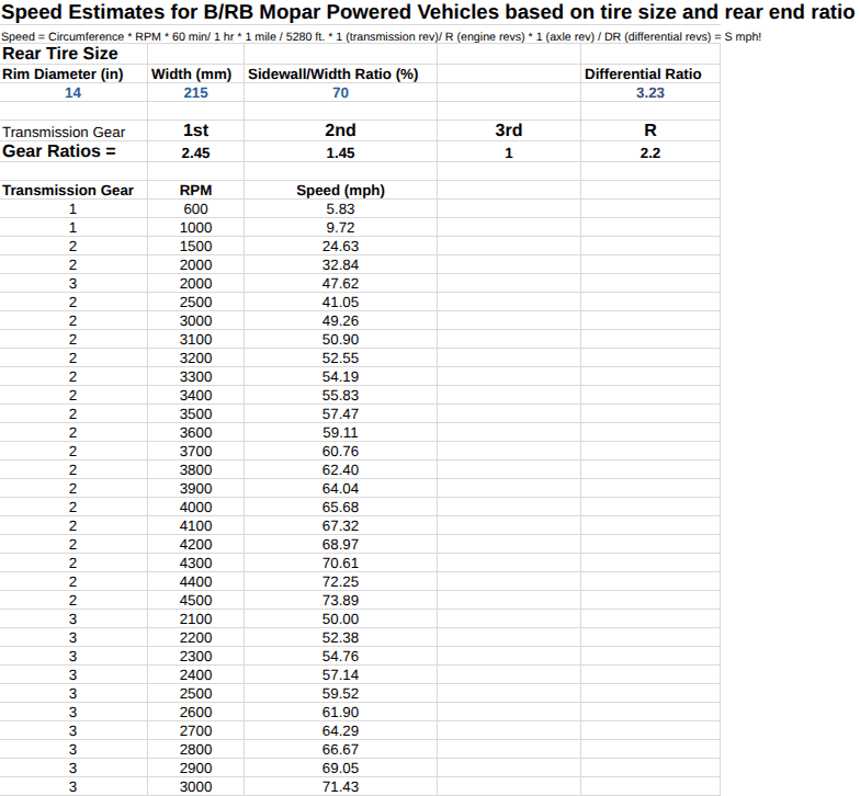

Today I applied a little arithmetic for us on a simple spreadsheet to make it easy for folks to estimate speeds at given engine rotation rates (RPMs) in sundry transmission gears with a given differential gear ratio. One can vary the tire size and differential ratios. The arithmetic is done for you. Just stick with varying the tire size and that rear end ratio, and you can get meaningful results. It looks fairly accurate, based on the behavior of the two Newports I've driven this past decade, and I assumed the standard Torqueflight gear rations. Below is a sample meant for our current ride, and the spreadsheet is attached. I hope this helps you when shopping for tires, or selecting rear ends, and maybe the speedo-pinion gears even, though I didn't include them yet....
NEW MEGA LINK SINCE GOOGLE SUCKWARE IDJITEERS CAN'T CODE!
Below is a PIC of the sheet in action:
The MEGA LINK provides the ACTUAL SPREADSHEET! GOOGLE BLOWZ DEAD DOGS BY TEXAS HIGHWAYS!!! DROPCOX LICKS UP THE SPEND AFTERWARDS!!! "The Cloud" has taken on a BROWN TINT and STINKS enough to make a damned buzzard PUKE!
I tested my work against reality last night, and it is good! I hope you all can use this little widget when selecting new rolling rubbers or rear end gears.

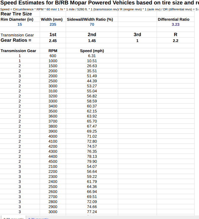

Great chart, but 15" tire sizes would help many more of us.
Then enter 15 in Cell A5. Enter the width of your tire in B5. Enter the Sidewall to Width ratio in Cell C5, then enter your rear end ratio in E5. You should have FULL EDITORIAL FREEDOM IF YOU DOWNLOAD THE SPREADSHEET, OPEN IT, AND EDIT IT AS YOU SEE FIT! I'm in a Killing Fury with Google for ******* up the original permissions on this sheet when I expressly Shared the link to Whoever, so I loaded it onto one of my Aussie accounts, so you all can download the sheet and use it.

Folks, I NEVER expected SO MUCH DIFFICULTY with editing a downloadable, free spreadsheet. JUST to show what a 15 inch tire size looks like, I typed in a common tire size, R15 235/70 and screencapped that for you to look at.

Nice work, Gerald! I was able to download it from your link and I was able to change the different options, including the rim size.
