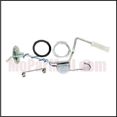

I had the same trouble with cheap overseas sending units. Purchased a unit (non-asian) from mopar mall and had no problems. Installed in original tank. https://www.moparmall.com/2584947-fuel-trank-gauge-sender-sending-unit-p/303-013.htm They normally offer 15/20% off during holidays.
Not made of Chineseium which I like A LOT!!!! Wonder what changed from 1969 to 1970?
