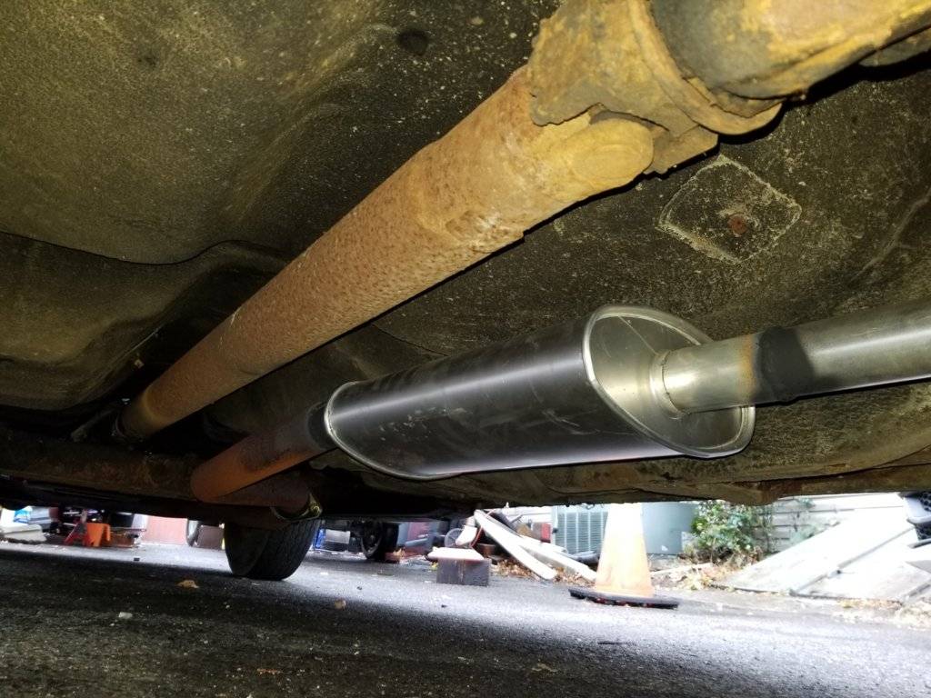

UPDATE: I got the carb rebuilt by a reputable shop and changed out the plugs. (sorry not pictures right now but will post them later today). The car runs very well now. (still running off the external tank).
The next thing I want to tackle while waiting to get the gas tank back is to replace the muffler since it has a hole in it. Upon searching online by year and vehicle model, it seems no one has a direct fit aftermarket for our cars. Does anyone know what the inlet/outlet sizes are? I can probably find an aftermarket muffler knowing that info.
My suggestion is measure the inlet/outlet with a set of calipers making note of any offset. Measure overall length width and thickness. Then start looking online and I'd be astounded if you didn't quickly find a match.

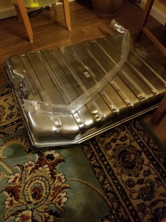

The new gas tank just came in. It's a Spectra Premium CR20B. Looks to be an identical match to the original tank. Also ordered a replacement sending unit, filler neck gasket, and tank straps to go along with the install.
I decided to replace the tank for piece of mind after I began cleaning the original tank and small pinholes started opening up where the metal was pitted. I considered soldering the few pin holes but I did not want to risk having other thin spots end up popping into more pin holes especially after having the tank full of gas.

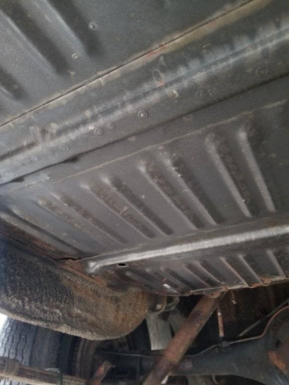

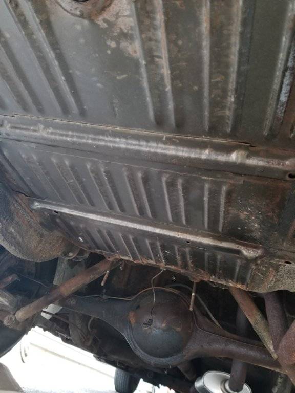

The under side of the trunk pan above the gas tank is super clean!
Looks almost as fresh as the new muffler.
