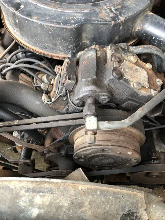

I think I am going to pull my engine, and this is an AC car. What is the proper way to disconnect all the hoses / equipment? I am not even sure any of it works.

I am assuming that you engine probably does not run or you would have started the car to test the A/C. If this vehicle has an RV2 style compressor, it came from the factory with R-12 as a refrigerant. A lot of these systems have been converted to run on R-134a. This conversion usually results in the compressor failing after a year or two. You can test the compressor by placing a socket on the bolt that holds the clutch assembly in place. If you can turn this bolt and rotate the compressor crankshaft two full turns, the compressor is likely still intact. Next, look at the hoses where they attach to the compressor. If there is an acorn cap on the low side and high side service ports, the system was last charged with R-12. If the acorn cap was replaced with a snap type coupling with a plastic slip on cap, the system was converted to R-134a. This is a legal requirement for the R-134a conversion.
If the system was last charged with R-12, the system should be evacuated to remove any R-12 that is still present. If the compressor has seized, it is very likely that there is no refrigerant left in the system as the front seal in the compressor will have failed when the compressor burned out and seized. This would be true for either type of refrigerant.
You should down load a copy of the FSM for your vehicle. The Air Conditioning section gives details on how to disassemble the system. Some of the disassembly instructions are also covered in the Engine Section under Removal. If you plan to reinstall the A/C components, care must be taken when disconnecting the fittings. Many of the A/C fittings are aluminum and the threads tend to seize and this can result in things getting broken. I usually take a propane torch and heat the fittings lightly to help free them up. BEFORE TRYING TO DISCONNECT ANY FITTING BE SURE THAT THE SYSTEM IS FULLY DISCHARGED OR SERIOUS INJURY CAN RESULT. Have somebody who knows what they are doing check the charge first before trying to take anything apart.

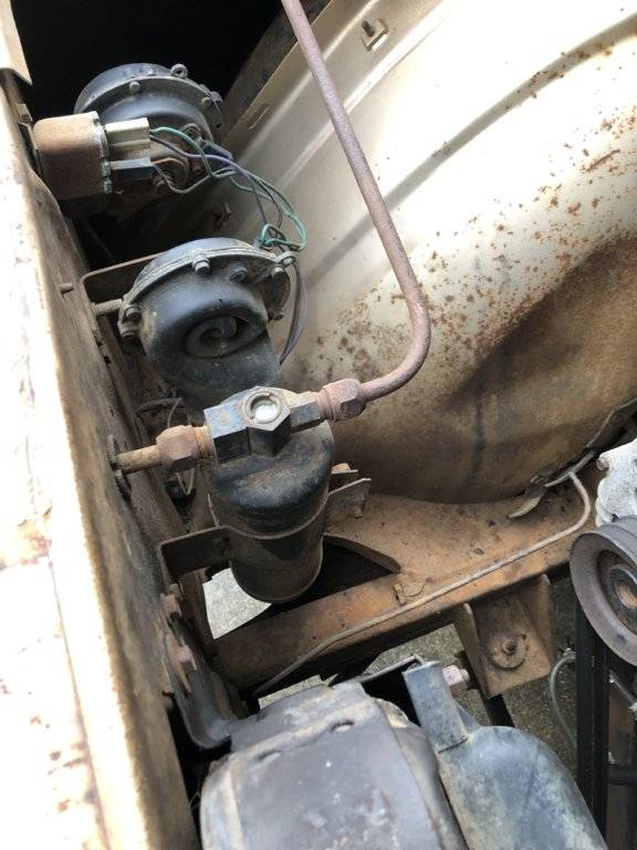

here is what i got.....
RV2 compressor, last charged with R-12. High side lines are very rusty indicating extreme care to remove if you are going to try and salvage them. Remove one of the acorn caps, you will see what looks like a tire valve inside. Gently push on the stem to see if any gas vents out. If nothing vents, you can disassemble the system. The fittings on the filter dryer are probably fused to the line, so give them a shot of "break free" or some other penetrating oil before trying to remove them. Same holds true for the rest of the fittings. Evaporator fittings are especially brittle as are the condenser fittings.
