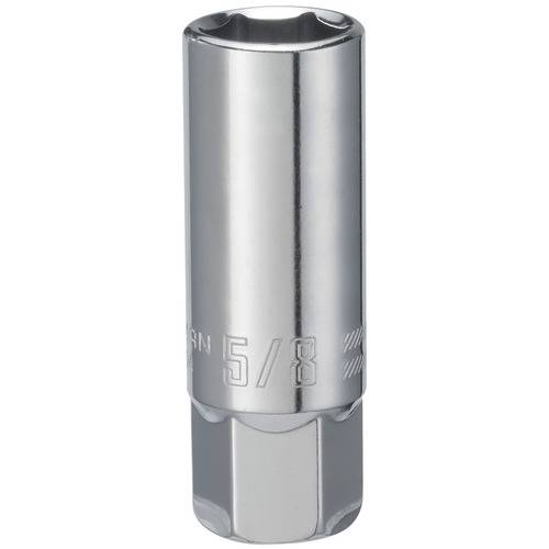

Here's the secret...
You need to be using a spark plug socket that looks like this. See the hex on the end? Use a 3/4 (or 7/8 whatever it is) box wrench on it.

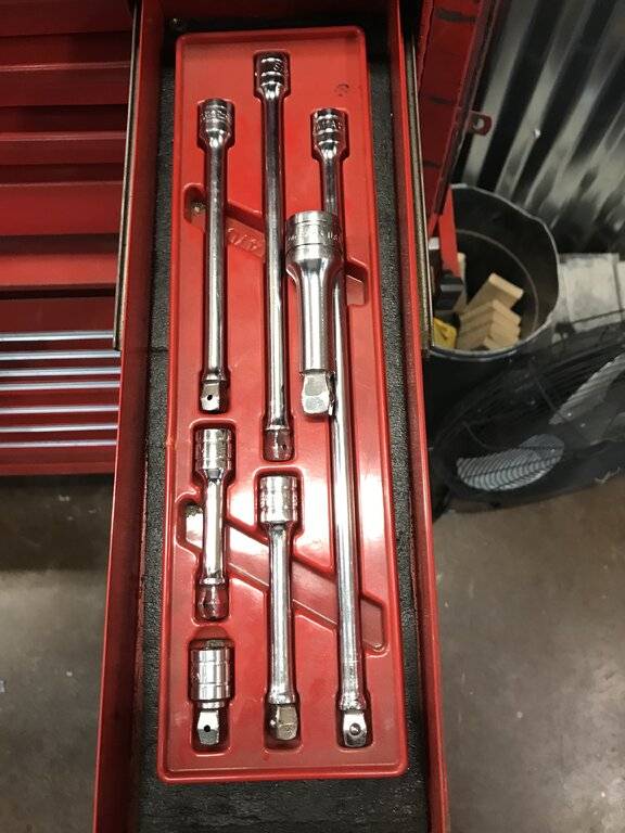

As above ( spark plug socket) and ball extensions. Best investment I ever made. I hardly use regular extensions and the U joint ones suck.
