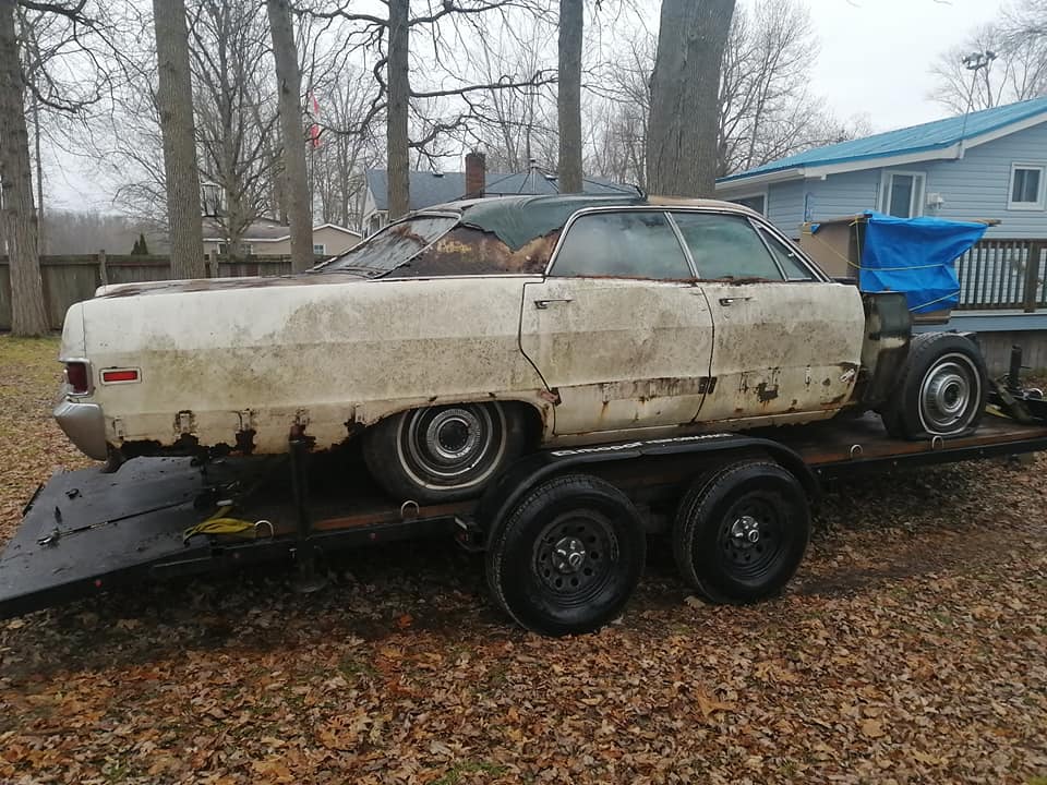

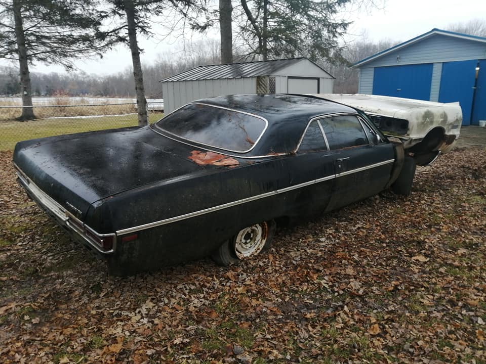

Contact Nick Winter aka
'69FuryIIIConvertible
He just finished chopping up 2 69 parts cars and may have a workable harness.
Tell him I sent ya.
