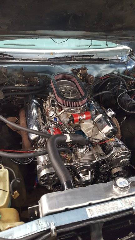

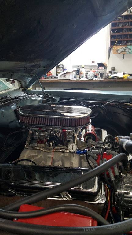

I am looking to buy an edelbrock manifold but not sure what to go with ? Its for my 383 the two iam looking at are # 2186 or # 7186 also will they fit without hood clearance problems ? Its on a 65 plymouth fury 3. I will enclose picture. Any advice is appreciated.

The Performer should fit with no issues, stock type manifold. The RPM needs the linkage bracket modified to work, and is a step up in performance.
Don’t know if it will fit under the hood but the RPM intake is a great manifold. Fits under the hood of my ‘73 with no problems.
As mentioned, will need some other goodies to make it work.

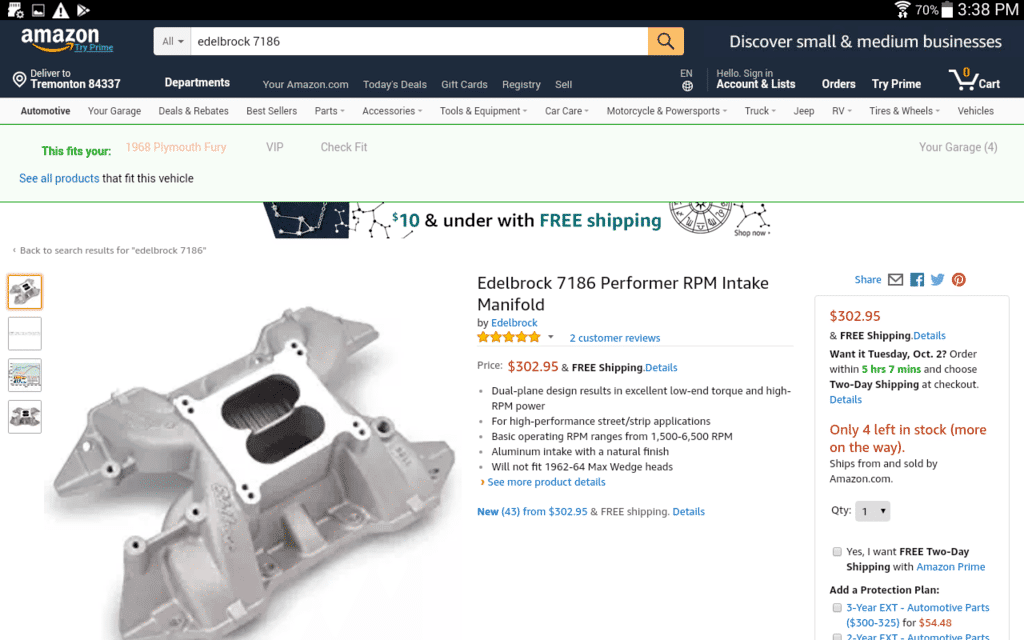

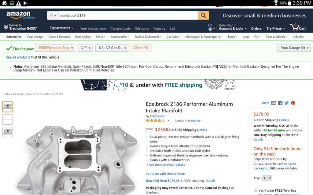

The RPM (7186) will need the linkage kit as mentioned above, fuel line modification and a carb with an electric or manual choke as it has no heat riser passage. You should also block or remove the heat riser when going with this manifold. The RPM is a better choice in terms of performance if you intend to or have already built the engine significantly. If you are just upgrading from a 2BBL to a 4BBL carb and do not intend to do anything else, go with the 2186 as this will be a straight bolt on.

Edelbrock used to have a graphic for each manifold so you could compare the carb mounting plate height to the stock manifold in their catalogs. ONE caveat with that is that Holley 4160 and Edelbrock/Carter AFB/AVS carbs are less tall than TQuads, which can also figure into the manifold height situation. PLUS the tallness of the air filter element/case. Might need to use a long bolt for the air cleaner hold-down rather than the supplied carb air cleaner stud, for hood clearance issues, too.
Many times, discretion is the better part of valor in choosing engine parts. I'd go with the basic Performer first. IF and when you do any other upgrades in camshaft AND rear end gears, then the Performer RPM might be more appropriate. You can always put the basic Performer on eBay or similar to sell it later on. Start "smaller" and work upward as necessary can be the best advice here.

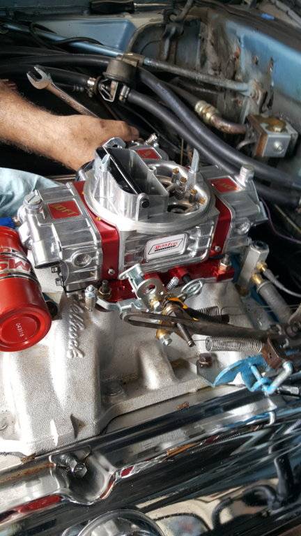

I have an RPM on my 400 in a 78 New Yorker. It fits under the hood and I used the stock linkage.
I used a Holley Quick Fuel 750 and a 15.5" oval Billet Specialties air cleaner assembly with a K&N filter.

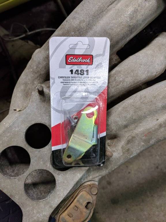

Here's the adapter, Edelbrock P/N #1481
Take your rod off your old carb and put it on this piece, hook it up, and drive.
Use the 7186 RPM, best of all the collective years of development. No bad habits unless you drive in the dead of winter north of the Mason Dixon line.
I assume that is for hooking up the original gas linkage to the carb, right?

On my 65, the RPM cleared the hood enough for a 14x4 filter.
I don't do any cold weather driving, so plugged the crossover as well.
The linkage required a couple longer bolts and 2 spacers going into the intake, not a big deal.
The intake works well if you have headers or a cam swap. I wouldn't think it would get as good gains on a stocker with log manifolds.

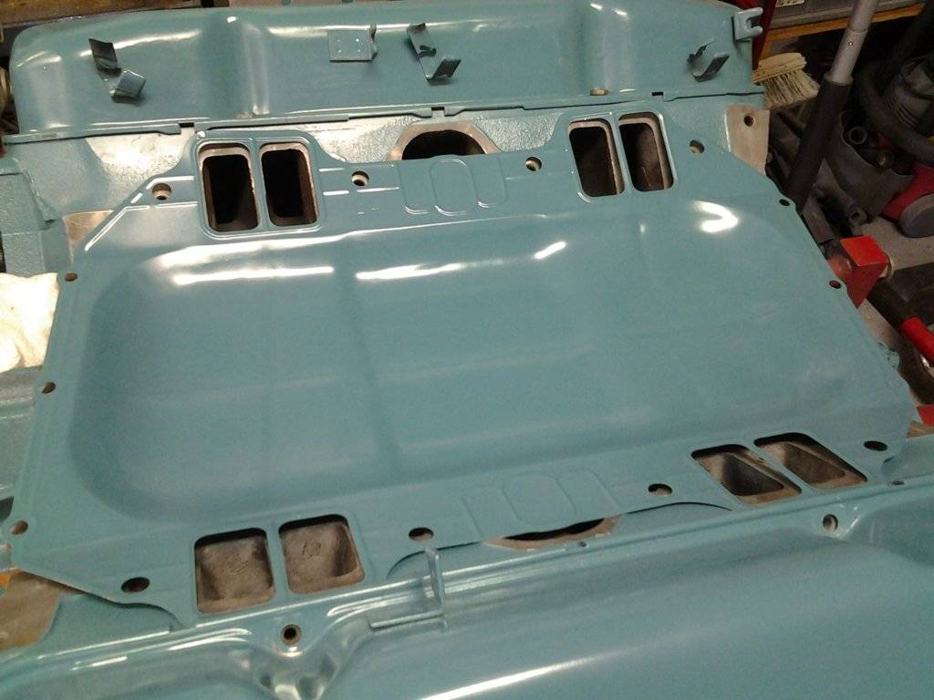

Thanks again for the info guys, i think iam going with the 7186 and the 650 avs carb. I dont have headers but i have the hp manifolds and duel exhaust. I have a valley pan gasket with the crossover ports blocked off. Is this the right one for this manifold ?
Usually a good idea to run a fiber type composite gasket on the top side of the embossed metal gasket with an aluminum intake, That keeps the steel gasket material from wearing groves in the soft aluminum material of the intake.
Dave
Thanks Dave, my gasket come with 4 fiber gaskets they say to put one on both sides of the valley pan is that a good idea or not ?
