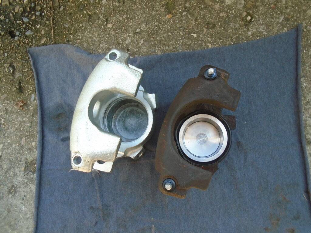

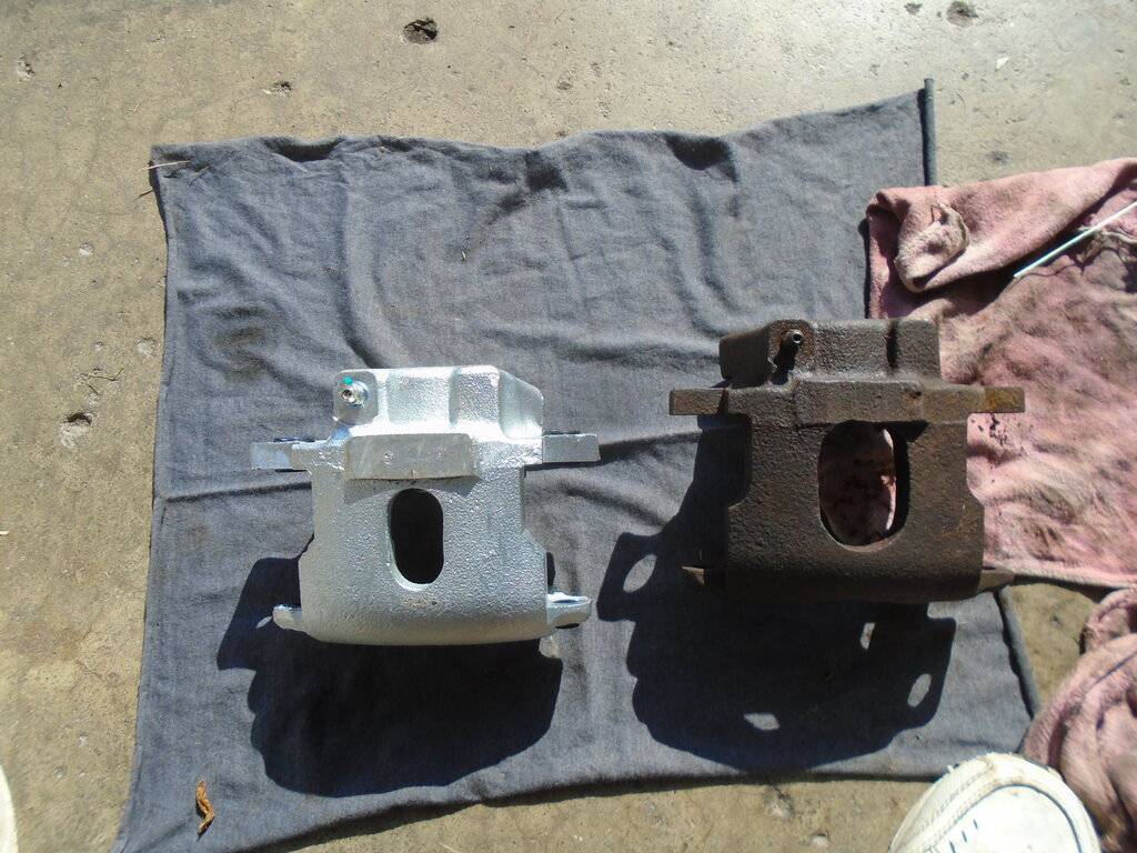

david hill
Jul 17, 2017
1,171
2,108
indianapolis 46226
I'm a tich skeptical of this statement, while they do have the same design the C-body stuff is just slightly larger and I think the corresponding pins are just a bit longer then the B/E body set-ups....but I could be wrong. ;)
Here you are. The guide pins are identical in length. The caliper to the left is a 1973 Challender while the caliper to the right is a 70 Chrysler 300. The Challenger guidepins are shown installed in photo #3

@david hill ...Thank you for the pics, but did you get those mixed on the left and right?? C-body calipers are slightly larger then the B/E body units and by the pics it appears the old crusty one is a C-body unit while the shiny new looking unit I would say is a B/E body unit.
I went through this issue many years ago when I did the 73 C-body disc conversion on my 68 T/C wagon, I ordered LH and RH calipers but the LH side caliper wouldn't fit right....messed around it for a while and finally figured out what the problem was, the caliper was slightly smaller then the RH unit. Returned it and got a correct C-body caliper and all was well.
If you look at the bleeder screws both calipers are from the side. The actual mechanics and dimensions of the seals, caliper piston, Caliper pin hardware and dust boot are the same. I used the Challenger Calipers as a doner for seals, pistons and mounting hardware for the 70 300 calipers.
