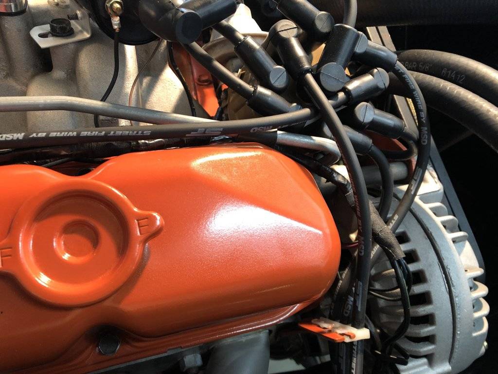

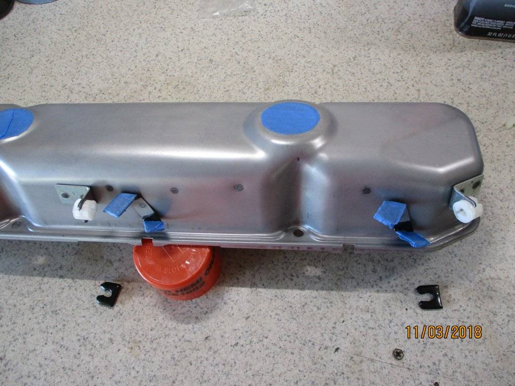

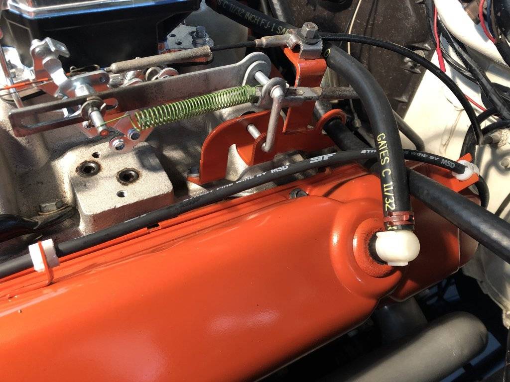

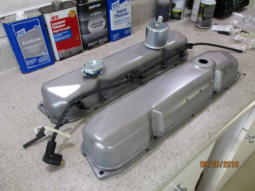

Trace 300 Hurst
Professional Tinkerer
May 27, 2018
2,162
2,678
Ponte Vedra Beach, FL
Valve Covers | AMD 335-1069-BP
Valve Cover Fastener Kit 1964-74 383/440, Valve Covers/Hardware, 110-VCF8033 Reproduction, NOS and Used Mopar Muscle Car Parts
Engine, Valve Covers/Hardware :Mega Parts USA
Hoffman's Winners Circle Ignition Wire Brackets

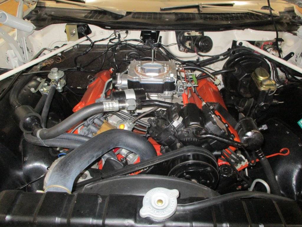

That's true, but I figure I'll give it a go. They seemed to have pretty good reviews. To quote Bobcat Goldthwaite, "This is either gonna be really cool, or it's really gonna suck." It's not a show car or my primary ride, just a fun "little" coupe to cruise around in.
Amazon product
