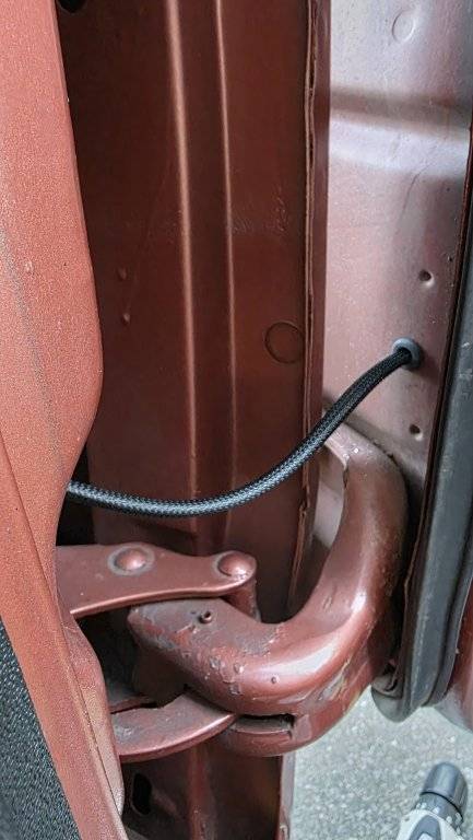

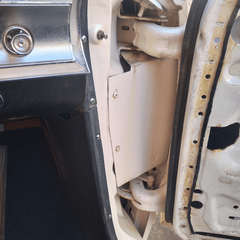

In the USA, heat shrink tubing is pretty much everywhere. As are the heat-shrink butt connectors. By the same token, GM has a plethora of connector pigtails available, all with white wire insulators so you'd have to pay attention to the color code of the wires they attach to. MANY are weather-protected OEM-style terminals, too. It is ALSO possible to get the OEM-level solderless connectors and related shield/insulators, too. So, with some careful shopping, a complete wiring harness can be made using OEM-level components. Which was the main claim to fame of Painless Wiring in its earlier days . . . using Packard OEM wiring, terminals, and connectors.
Which brings up another issue, which is the necessity of the "door wiring boots" between the car body and the door shell itself. Possibly salvage yard parts? As might be the complete wiring harness from a car with power door locks? Which could mean you can get the complete system (including the receiver box and antenna) from the donor vehicle(s). Then knowing the model year and brand of the vehicle (which can include the VIN, if the box has it programmed into it), then buy some factory-replacement key fobs from an internet source, or even the dealership.
