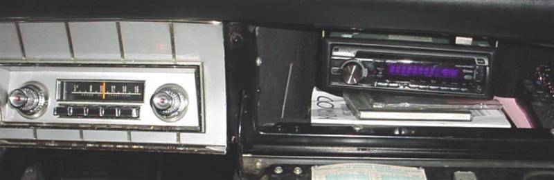

The last time I mounted a modern radio in an antique car, I got the smallest one i could find and put it in the glove compartment.

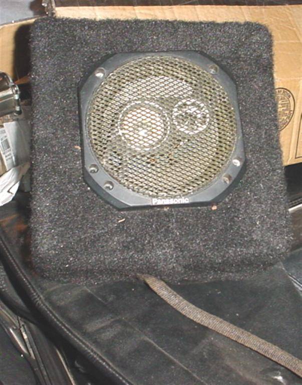

I did the same thing in my 65 Coronet. I used a Kenwood that still left enough room to store my car paper work and some maps. I didn't want to cut into any interior panels for speakers, (it's a convertible), so I mounted a pair of 5" round three way's in wooden boxes, lined with foam and carpeted the outside. I used 10' of speaker wire for each speaker, routed under the carpet and passenger seat. Now I can place the speakers on the conv boot or outside the car to enjoy music where ever.

Good question and I like your idea you used on your '65. Do you have any problem with the radio getting too hot in the glove box? Funny thing is I did something similar in MG, mounting some speakers in a box, but I threw away the speaker boxes I used. They were pre-made black PVC for 6X9 speakers. I put down some Velcro to keep them in place 90% of the time, and then could move them if I wanted too, and nothing was permanent.

Do you have any problem with the radio getting too hot in the glove box? I like the idea too, to use the AM radio as an on off switch for the new radio. Cool idea.[/QUOTE]
No problem with overheating. It also has a remote control but the metal glove box door blocks the signal. No big deal as the only feature I use is the "AUX" for the MP3 player.
I built my speaker boxes with 1/4" plywood.... nice and heavy. Lined with styrofoam inside and auto grade pile carpet on the outside, they sound great.
