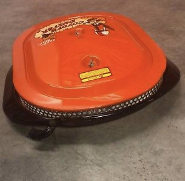

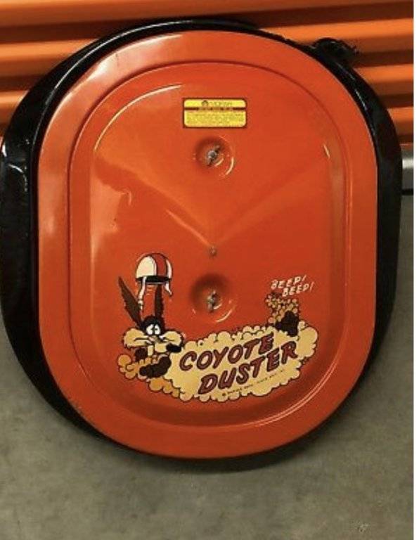

The REAL Corvette OEM open element air cleaner is the highest flow filter case that was ever used, according to tests back in the '70s. It sits ONE inch lower than the more common knock-offs that are sold everywhere, with the simply-stamped lower plate (of thinner metal than the OEM item). But it's also designed around the Holley 3310 4bbl that was OEM on the big block Chevy V-8 that the filter came on from the factory. The knock-offs probably work as well, I suspect.
To me, the C-body air filter top with the "Road Runner" base is better than even the Road Runner air cleaner as there is MORE distance between the outer edge of the top and the filter element itself. Just need the "Holley"/larger mounting hole carb to go with it.

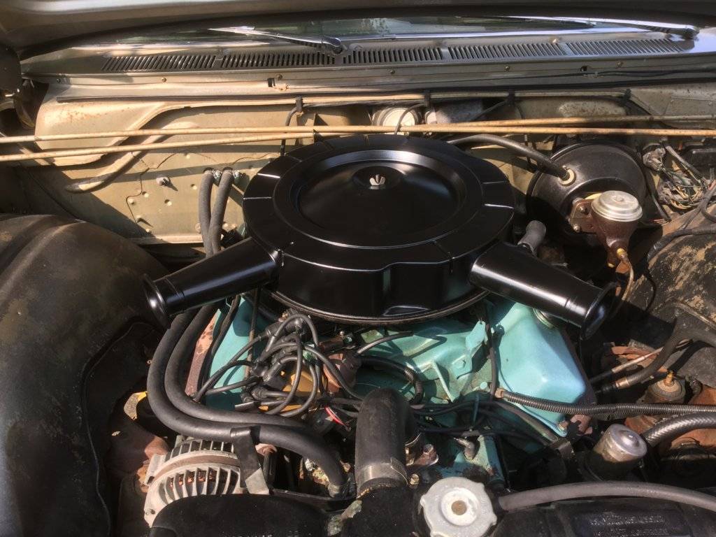

I replaced my original single with this dual snorkel cleaner just cause it looks cool.
No noticeable performance change but there is a noticeable increase in noise at wot.
