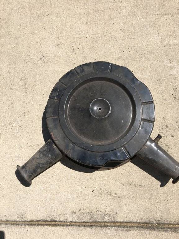

I’ve had this sitting on a shelf for years and can’t remember where I got it from (jeez). Is this a Chrysler piece, or is it for a GM car?

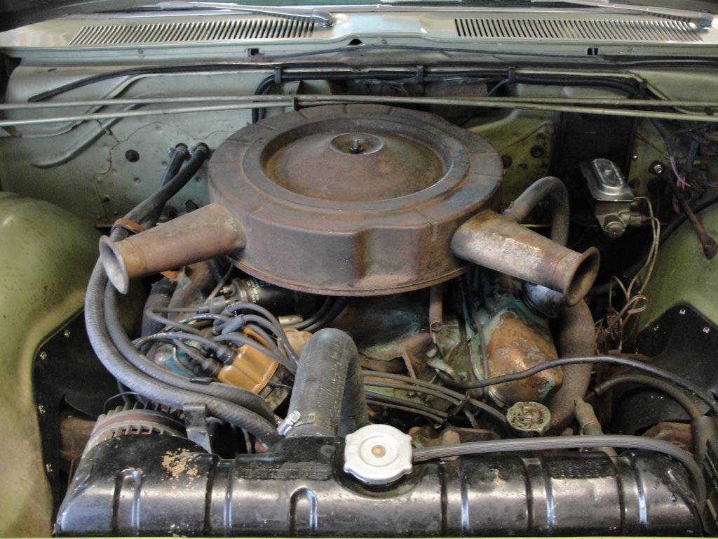

I believe mine is also a 68 with the small cone in the center. The metal pie tins won’t fit on these. The bases are interchangeable whether for a Carter AFB or the larger Holley carb mount.
Same basic "body" as the '65-'66 air cleaners, but with a different "end treatment" on the end of the snorkles. A 1968 "plug" at the end of the snorkel. From my experiences,
CBODY67
The nipple on the snorkel makes it a C.A.P. unit, (cleaner air package), required on cars manufactured for sale in California, optional elseware.
