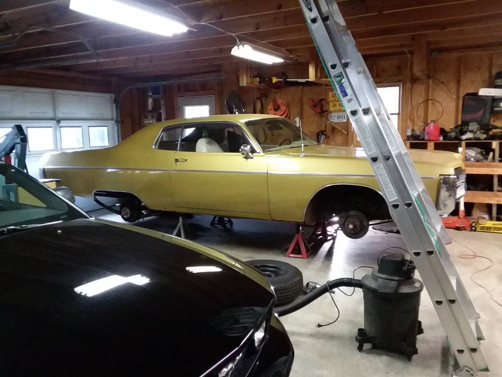

Here's your Fury's brother from Belvidere. My 72 Fury saying, "Please let me off these jack stands."
Yep....I know that feeling....my was on stands for almost 8 months. Good to know someone else has one in VA too.
