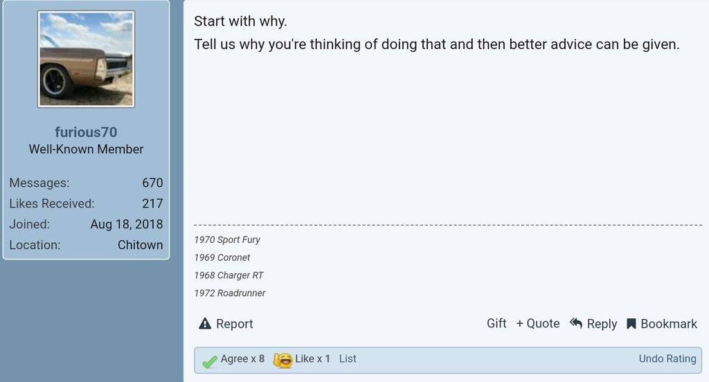

Start with why.
Tell us why you're thinking of doing that and then better advice can be given.
