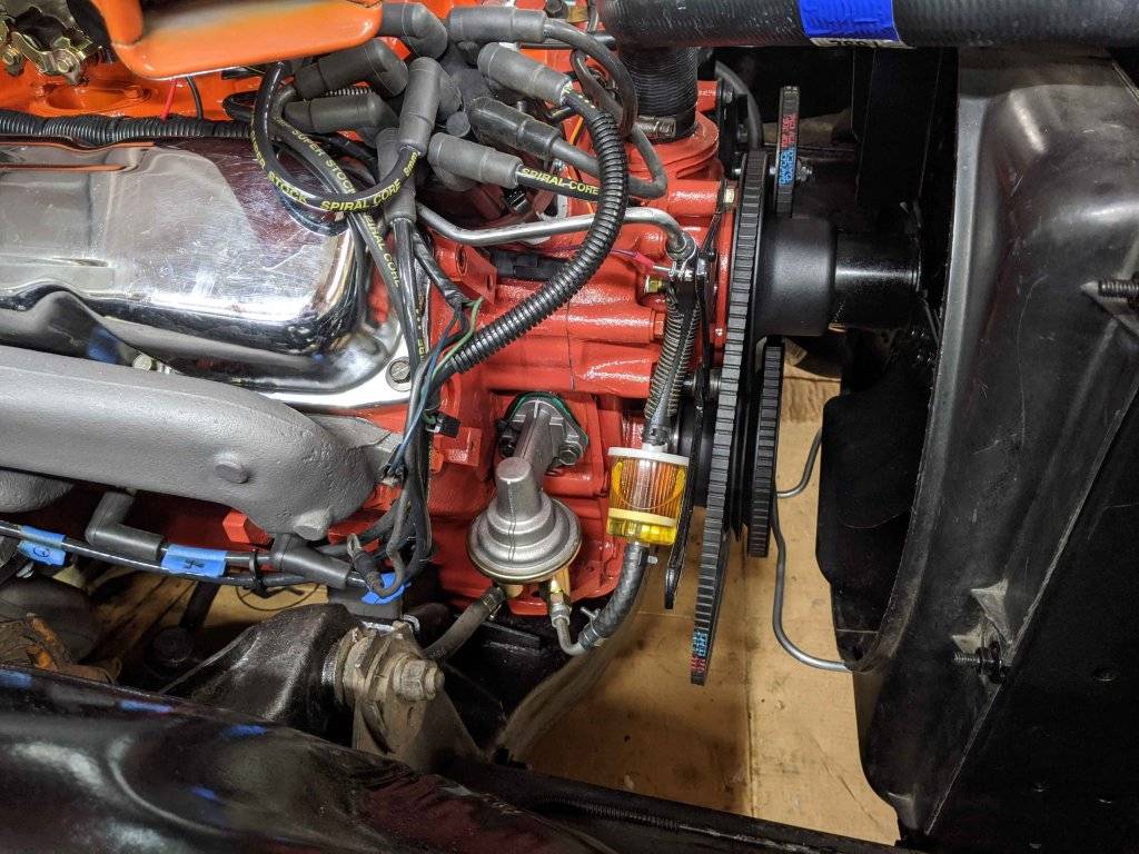

I'm running both my fans on a relay that is wired to battery. I have my temp sensor in the top of the radiator and comes on at 180 F. After driving the car and parking it the fans will run for 3 to 5 minutes after the engine is off. At first I had the sensor in the thermostat housing but the fan would run for almost 10 minutes after turning the engine off and I didn't want it to run that long so I moved the sensor to the radiator.

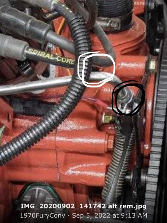

In your photo- is the temp sending unit where your fuel line is circled in black? I have a plug in the area where it is circled white which i was going to use for the sender...
My temp sender is at the brass fitting with white sealant visible to the lower left of your black circle. I think the white circle area that you choose with the plug installed would work just as well. I admit, I don't know what running the temp sensor at the "top hose" means.
Also, I agree with using the temp sender to activate the fans via a relay.
