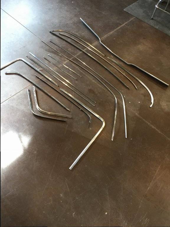

    All my window, belt line, roof rails,and hood front trim is stainless. Just dropped about 20 pieces off tonight to get polished. If there weren't a few dents and mistakes when I pulled it off I probably would have done it myself. Nobody wants to touch the aluminum, so if I want it done I will have to do it. I like doing mechanical things and building things, but removing dents and polishing just doesn't seem to be that much fun for me.

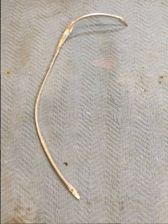

    I guess if I am going to learn I have to start with the first piece. I do have an extra piece of aluminum wheel well trim that is beat to crap that I can practice on. If I start with the worst pieces first time I get to the nicer pieces I shouldn't screw them up.
    Before: (you will have to wait a while for after)

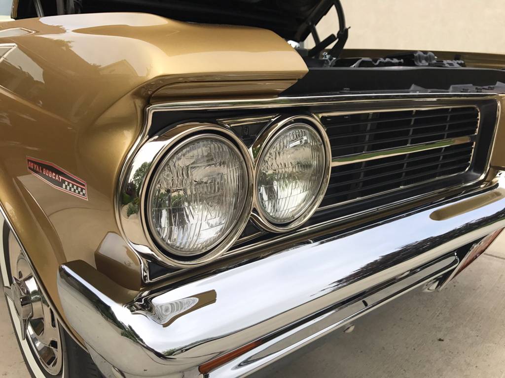

    Anodizing can be hit or miss and is expensive. Why not nickel plate the pieces? In the GTO hobby, the grills and headlamp bezels are hard to come by although the bezels have been recently reproduced. Anyway, a guy on my Pontiac board nickel plated the pieces and I think they came out really nice.
    • Like Like x 3

    Scott there is nothing you do that isn't 1st class. Do have a link to your GTO restoration? :thumbsup:
