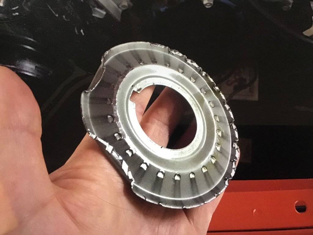

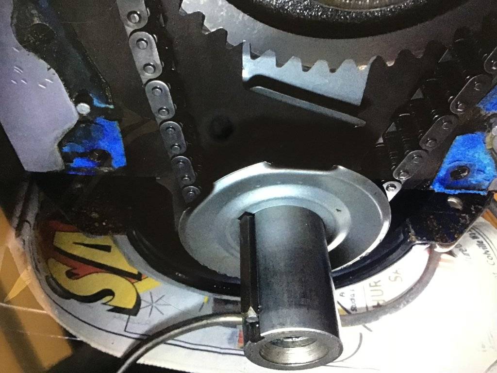

Don’t put the oil “slinger” on backwards, the chain will eat it and send metal in your engine. Bought a car like this.
