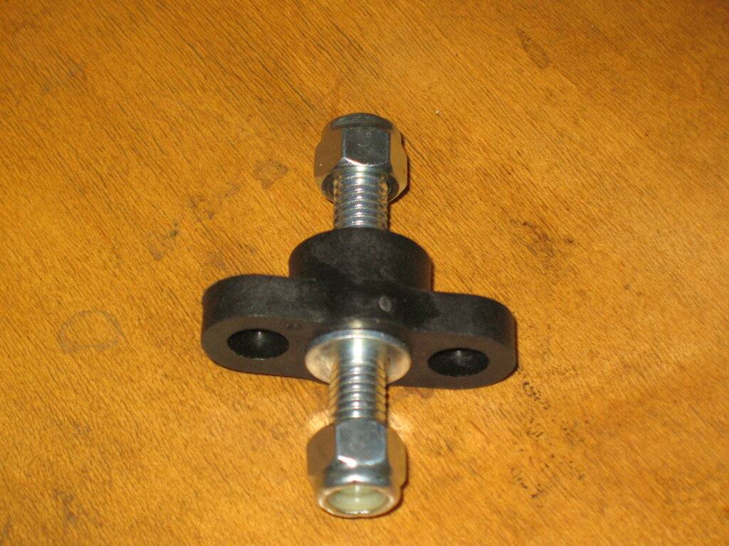

My wiring adventure started with an 8 gauge alternator connection. and a 100 amp alternator. Measuring the voltage drop from the alternator with that update indicated way too much voltage drop and the battery was never getting a full charge. This was before blasting the stereo. So I added a junction terminal and changed the wire to 4 gauge oxygen free copper. That helped with the voltage drop. The terminal looks similar to this:
One side goes to ammeter through the firewall, the other is the alternator feed. On the alternator feed side I tapped off to a fuse panel mounted under the hood. The headlight relays, stereo system, fuel injection and fans are powered from there. The point of doing it this way is so the ammeter will remain centered when the engine is running and the battery is fully charged. If you connect everything to the battery, the ammeter will indicate it is constantly being charged, which is incorrect. The ammeter is supposed to only show current flowing in and out of the battery, nothing else.
