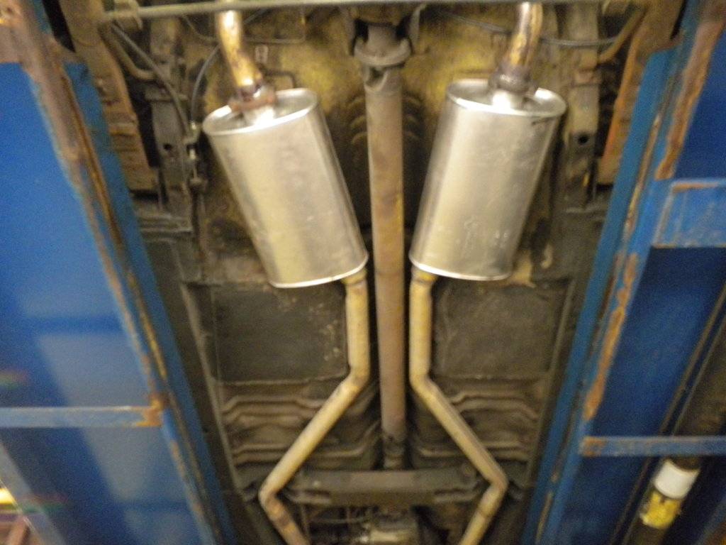

    My two cents: weld seams are prone to rust, so clamps would be the better way to build an exhaust system. The pic below does have the focus on the muffler, but you can see some weld seams as well.
    The routing of these pipes is not 1:1 with the factory and the Dynomax Super Turbos this short (#17733, 14`` body) are for the ``young at heart`` or a young guy.
    • Like Like x 1

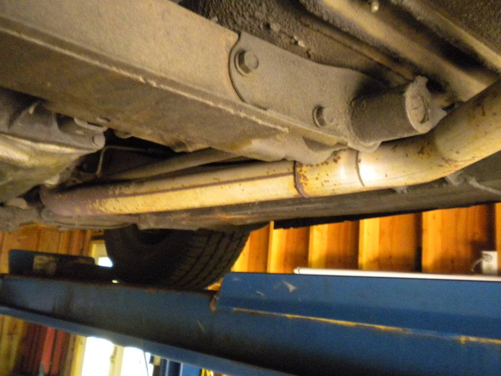

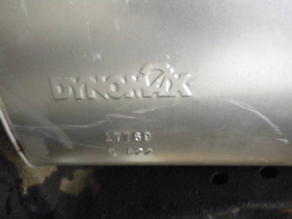

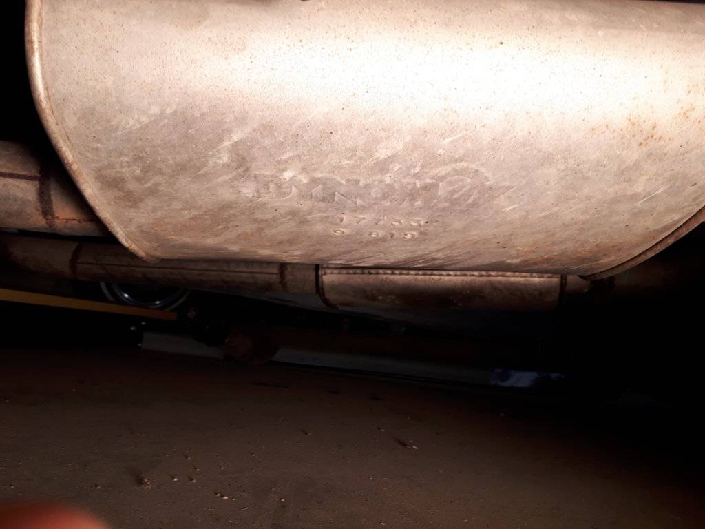

    my '69 newport. exhaust bent by yours truly circa 1987. exhaust 002.JPG how to cheat on over the axles exhaust 004.JPG slip fit at crossmember exhaust 008.JPG hooks exhaust 005.JPG mufflers exhaust 006.JPG part # exhaust 007.JPG 3 inch in and out offset/center bushed down to 2.5. year old but little road time. good exhaust isn't easy to bend. some have a knack for it. some don't. if you have experience with it, then you know.
    • Like Like x 1

    That system looks very good.
    As for welded joints, I'm getting the head pipes bent, and the tail pipes, mufflers will be clamped, only welded joints will be the tail to over the axle and the H pipe...
    • Like Like x 2
