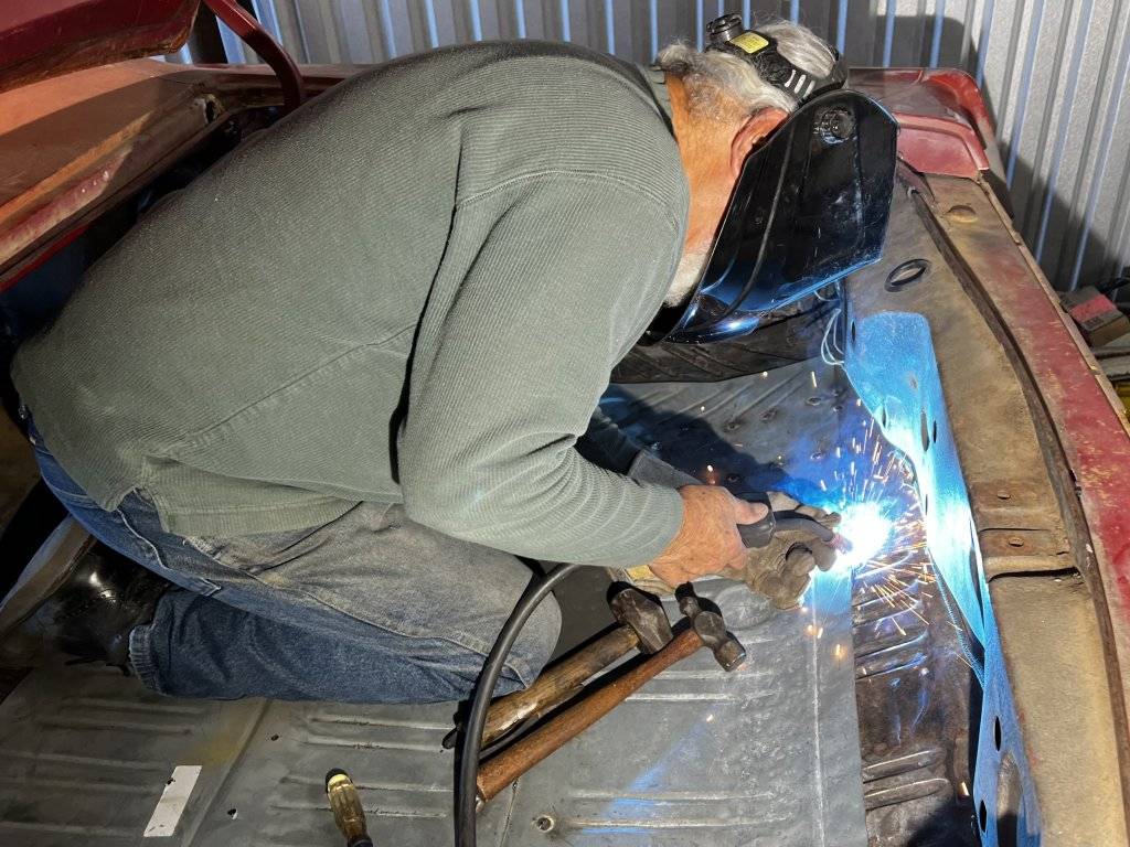

For now, we’ve replaced the trunk so far.

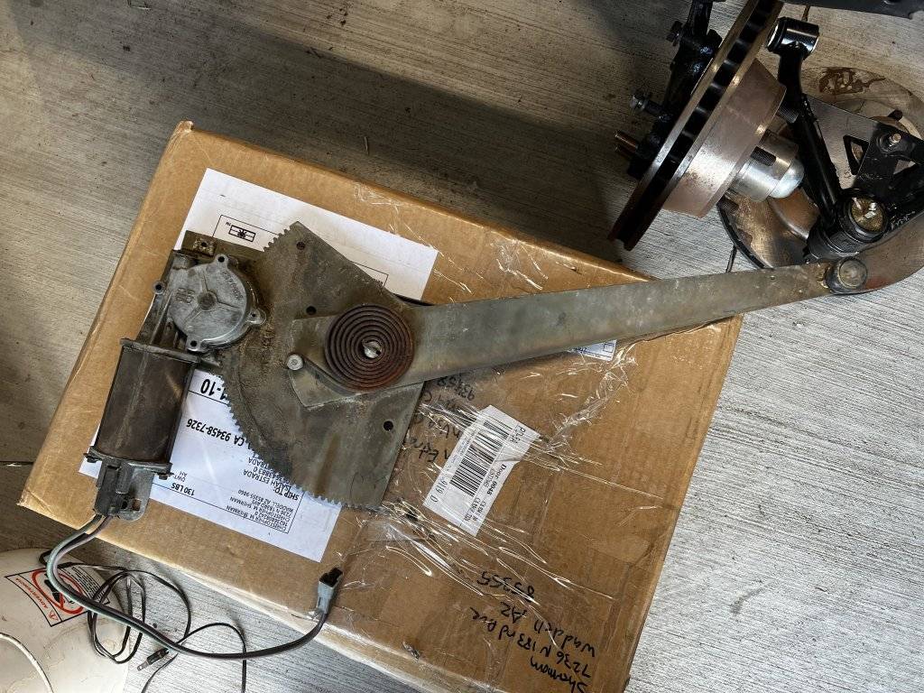

Going to be working from the rear forward. Lots of metal repair needs to be done but it’s mostly in the rear area. Some places on the roof that need attention. Namely under the drip rail which brings me to my current endeavor with the car. This New Yorker is highly optioned, power windows AND vent windows. Only problem is, they’ve sat for 40+ years and without any power to them. I need to roll the rear window down to get access to the screws holding the trim in place underneath the weather stripping. To do that obviously I have to remove the motor / regulator assembly because the motors are frozen. Thanks to the good folks on the forum AND Facebook I was able to tackle my very first one! Now 3 more to go…

Great work!
A little warning... The spring on the regulator is put there to chop your finger off. Search on here and there's several ways to make it safe to take it apart. Usually a bolt and nut through a drilled hole, or at minimum, a clamp.
Even if it didn't hurt you (and I'm serious about losing a finger) putting the spring back in place is a very difficult task.

Here's my thread on repairing power vents.
Power Vent Motor- Anyone ever take one apart??
This repairs a newer window motor with the roller clutch, but it will show you a few things.
How to rebuild Chrysler Power Window motor clutch assembly
Thanks Big John!! The whole finger chopping off thing was what held me from tackling this job a lot later than I would’ve :lol:
After looking over the FSM multiple times and asking those who’ve done the job before I finally realized where that spring was and what the best way to remove the motor / assembly was. I’ll definitely be looking into those threads, in fact I had those in particular saved too! Good to know I’m on the right track. I plan on taking out the entire vent window frame for easy access to the motor. Will be reporting my results in the future when I have everything cleaned up and (hopefully) in working order.
