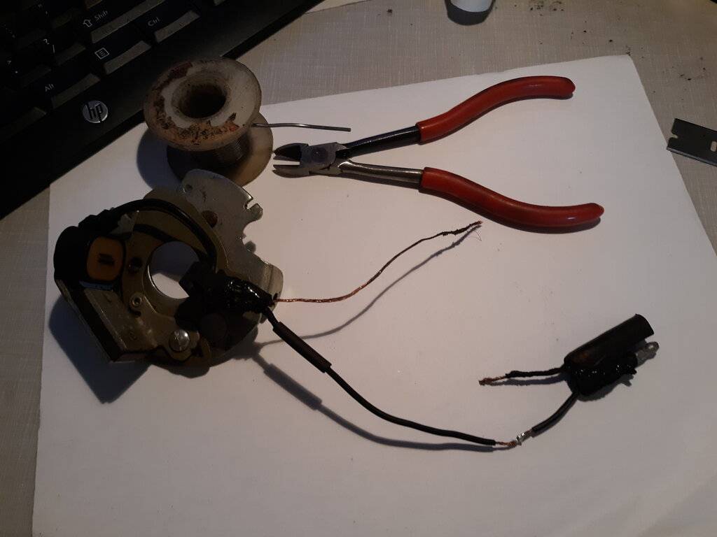

Epilogue to the is all is repaired to like new. Acquired a fan shroud from @Rainy Day, correct # matching, a big thank you from me. Thanks to @aylair @Trace 300 Hurst and others for there support and suggestions for parts suppliers. Had to fab a harness for the dist. , Have since acquired a treasure trove of dist. parts at the Garlit's Show. As seen below the dist. wires were cleaned then covered w/ 1/16 shrink wrap w/ an additional 1/8 short piece of shrink wrap to cover the solder joint on each lead. Any exposed area was cover w/ black silicone on each wire lead end. Proved to be a good repair, Now that I have a proper dist. pickup to install this will show an alternative repair when no parts are available. David
