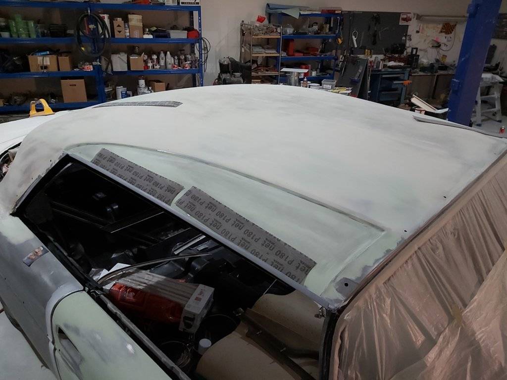

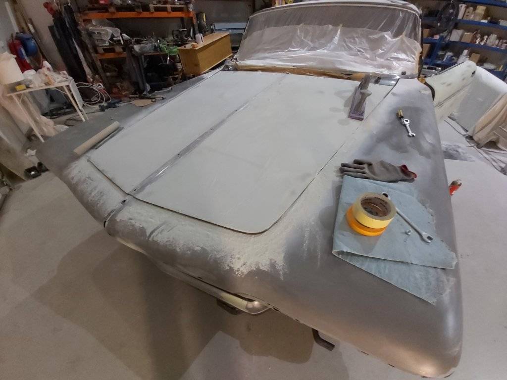

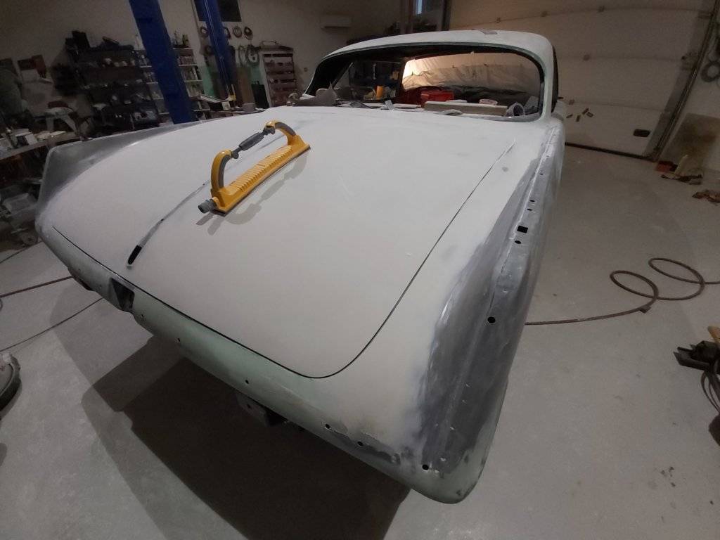

This is "quality" time with friend, sanding polyester filler! Last evening we had sanding session for my friend's -62 Imp. The roof needs final sanding but every other parts needs "bondoooo"! :p
Not too thick layers but still lots of work to do.
After all, I was winner. Meanwhile friend 's wife picked up some wild mushrooms ,just nearby garage, and she gave me a big bag off those tasty "wonders" ! Now they are already dried and waiting for "Mika's famous risotto".:D:D

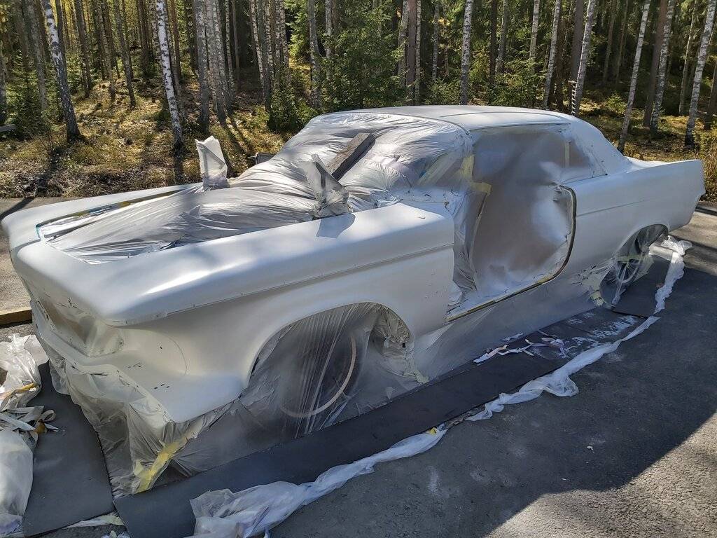

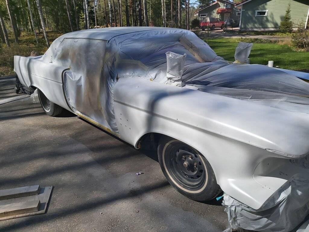

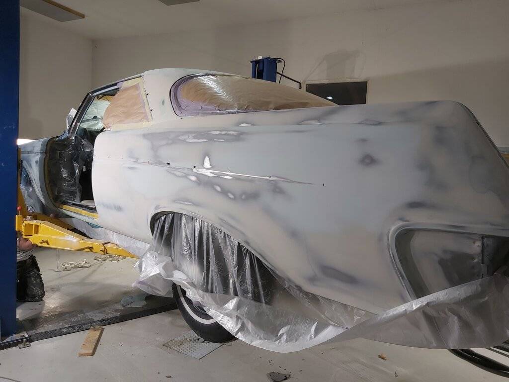

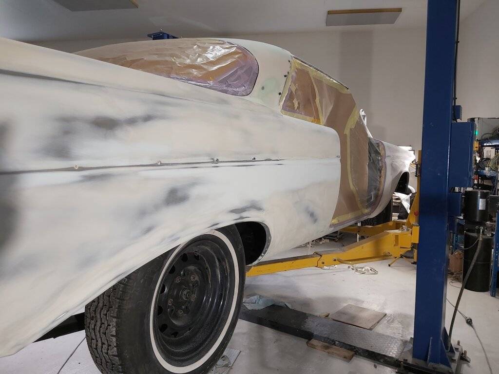

Finally some progress on this project. Basic bondo work done and today was time for a epoxy primer.

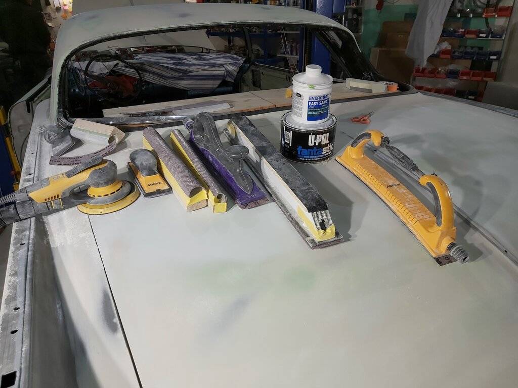

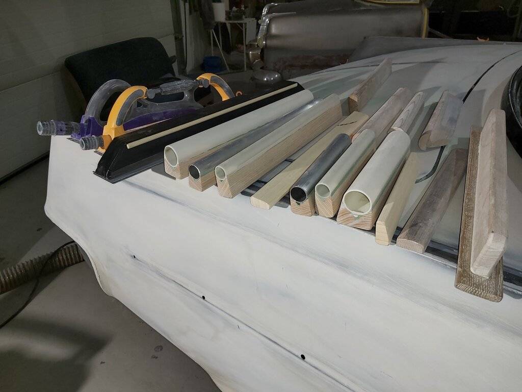

I did lots of new sanding blocks for this baby.
Next we will block sand that epoxy to find last areas for putty and then sanding sealer.
Evercoat Easy Sand seams to be a good finalize putty.
Day was so beautiful so we did spraying in garage's front yard.
