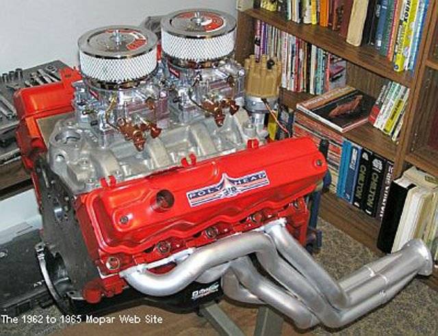

    If I was you, I'd warm up that 318 Poly. You can get a bigger cam for it, and you can even put multiple carbs on it (it'll really wail with a pair of AFB four barrels). If you do a complete engine rebuild, you can do even more with higher compression pistons, a larger bore, etc. Poly engines can make a lotta power, therefore, you could avoid a lot of hassle doing a 383 swap and the car would still have its original engine.

    Is mine a poly or LA? How can you tell the difference? Needing to magnaflux it and machine it and buy new pistons and everything was really starting to sound expensive and like a lot of work! Could you point me in the right direction to read the difference about a 318 poly and 318 la?

    If yer valve covers look like this, its a Poly:

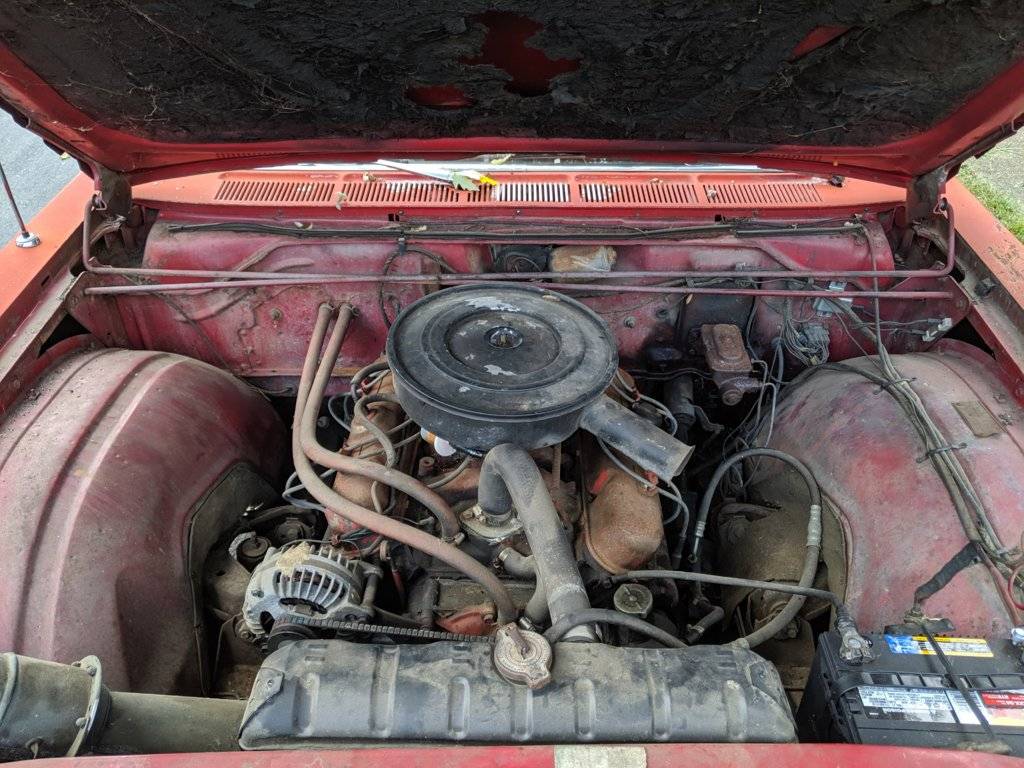

    yeah mine is an LA
