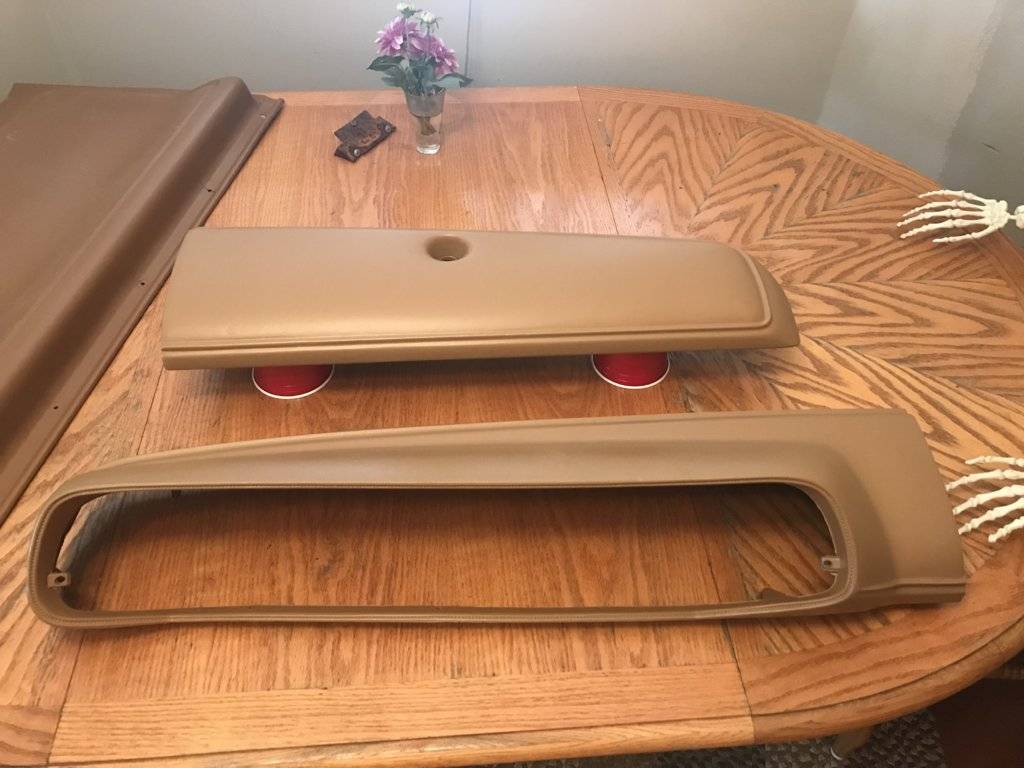

The finished product. Not too shabby!
Got some more stuff gussied up today as well.

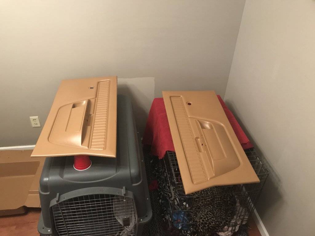

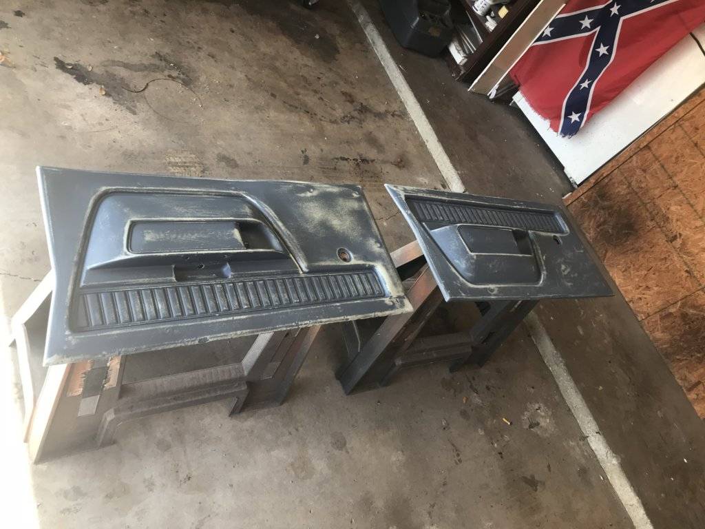

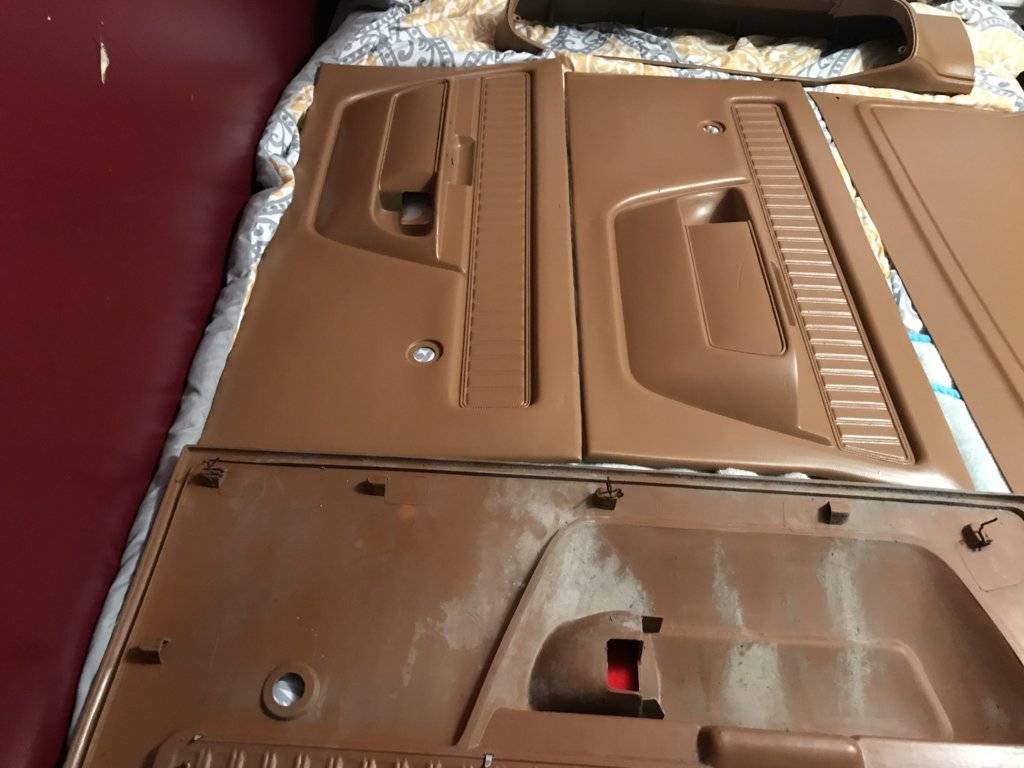

“New” set of door panels we picked up at carlisle. These aren’t great, but atleast they match. There was a mis matched pair in the truck. Only spent $20 on this new pair.
Somebody had painted them before, and it was quite a crappy job. Went over em with 180 grit sandpaper to get the loose stuff off first. Then on with the normal procedure.
Also got the one ok armrest done. Want to get a nicer pair before installing.

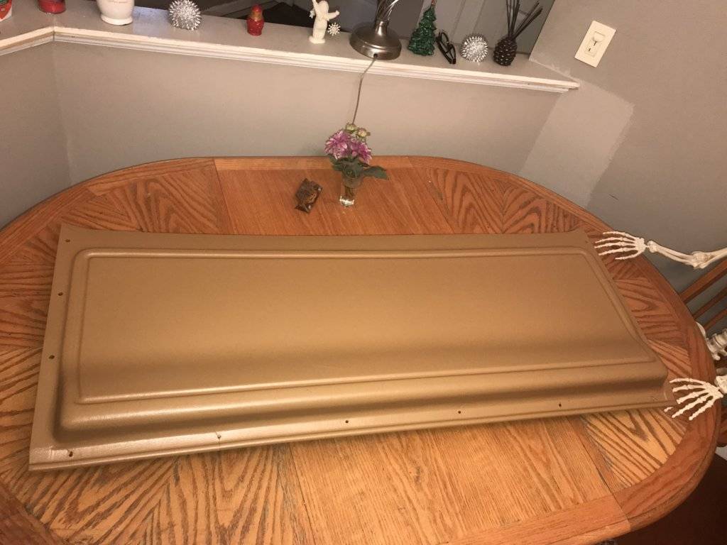

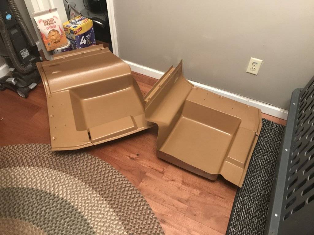

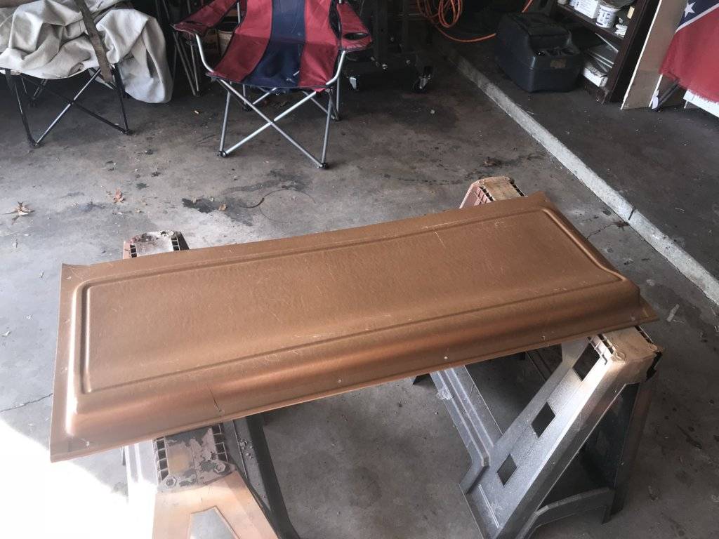

Back wall piece had some cracks up top. Fixed them with some 2 part epoxy, and fiberglass. Didnt bother filling the front of the cracks, just some new paint to help hide em..
Also got the rear side wall pieces done too. Same as the back wall piece. Fixed the cracks, and a new coat of paint.

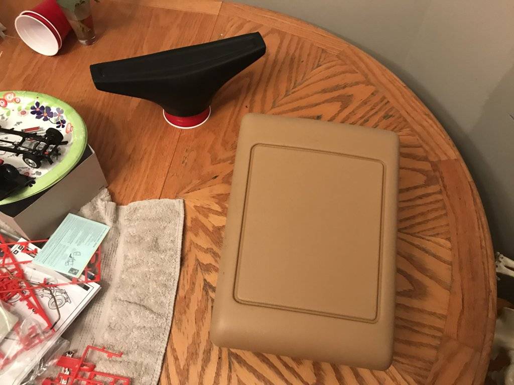

Just have the “new” center console left, as well as the dash. Should be a big improvement over what it was.

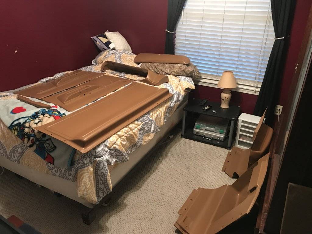

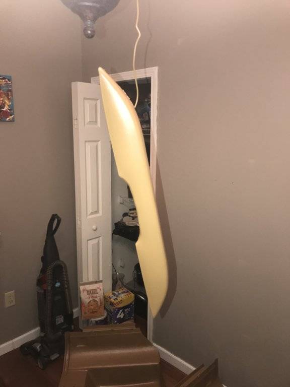

Truck parts hanging from the ceiling fan and all over the house.. I love it!!!! U Da Man!!!
Looking great! My plastic got the SEM treatment and it's wearing great.
Ofcoarse! If your cold, they are cold too! They are now tucked in, in the spare room awaiting install lol
Wow, I'm sold on SEM products after seeing the results.

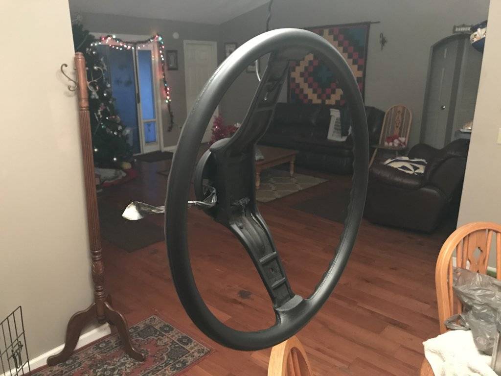

Hopefully they last! Thats the real test. I’m a bit nervous about the steering wheel. Not sure how good it’ll hold up being handled all the time. Luckily its the same color, so won’t he too obvious, but it deff needs some freshening up.
Here is a couple comparison shots from one of the original panels. New color is a tas lighter, but they can pass as factory I believe.

Got some more stuff painted today. I screwed up though.... Was a bit too humid to be painting. It started raining right after I started spraying ofcoarse lol. The tan is pretty flat, and has no luster to it. Hard to tell in the pics, but doesnt quite match the shine of the other panels. Oh well. Atleast it will give a little contrast to the other panels I guess. I have nothing to compare the black on the wheel too, so hopefully that atleast is correct.

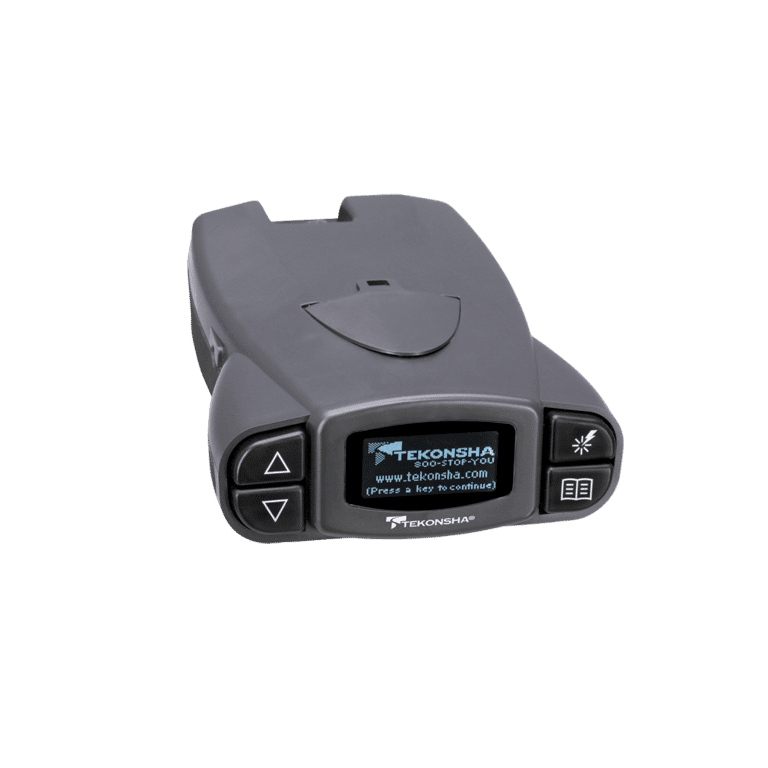

Also want to find a good trailer brake controller, that will work on the primitive truck. Im assuming just splicing into the brake light switch?? Idk.

Here's what I used. It's a 4 wire hookup. Power, ground,Input from brake light switch, power out to brakes.
Trailer Brake Control - Proportional

I'm using the Northern tool $59 special... no complaints. I am fortunate in that the burb was prewired from the factory so all I had to do is dig the wires out of the harness and connect the ends. Use the FSM to make the wiring connections and the controller directions to assure the correct fuses and relay connections... any of them should be easy to wire up, just don't get too far from power before the fuse and don't go too small on the wiring. Make sure you buy for 4 brakes...
https://www.northerntool.com/images/product/2000x2000/637/637225_2000x2000.jpg
Every time you load her the braking will be a bit different, if you work like me... you'll confuse the +/- at first, but get something that works good pretty quick.
