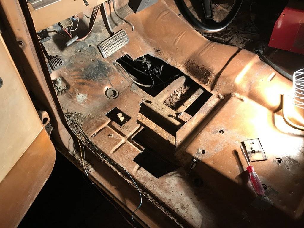

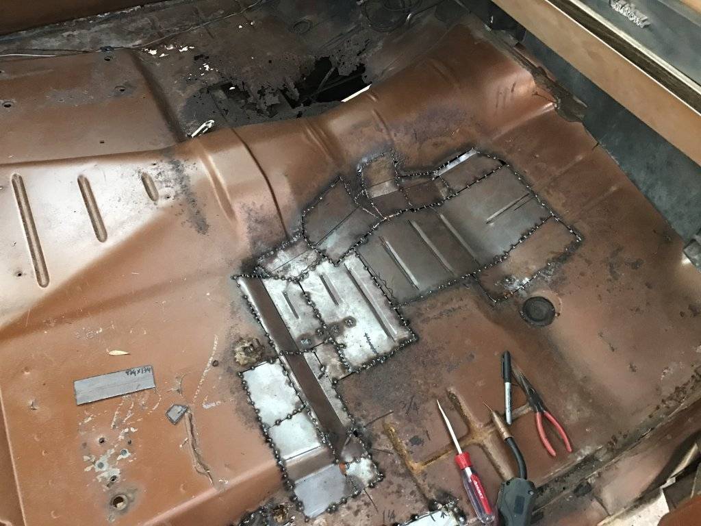

This weeks job in between painting the blumo is the floors on the truck. Ouch!!!!

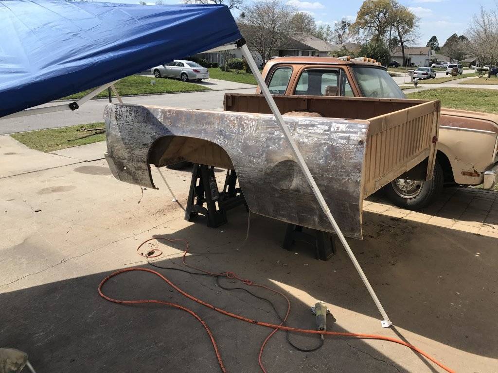

Sabrina is going to town with the needle scaler right now. Should be a fun week.
Gotta pull the bed too, and fix the front floor of it. At least the frame is solid, right?? lol
Luckily I still have quite a bit of sheet metal left over from the blumo.

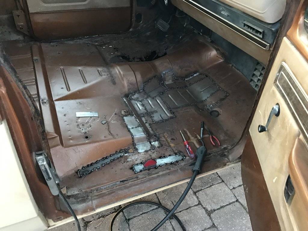

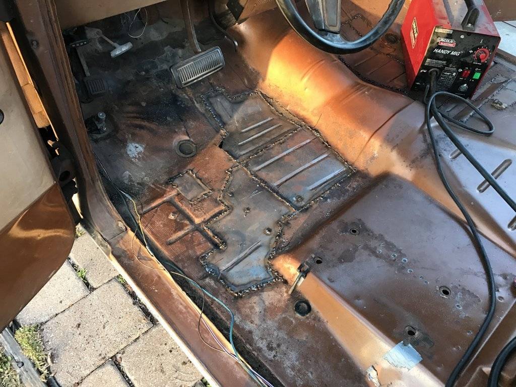

Most of the bad is cut out on the passenger side floor. Got a few patches going on. Woo!
It's a fun hobby, right?? Soothing, relaxing, almost theroputic... hahaha
Late nights working on her. Gotta get the bed pulled soon. Still need to figure out what to do about the drip rail... as well as finish the floors up. Bunch of parts, and paint on the way. Although, I won't be painting this one! Let a buddy do it.

Got the driver side just about done today. Ran outa gas... really need to invest in a bigger bottle! Gonna need another bottle just to fully weld up the passenger side I think.

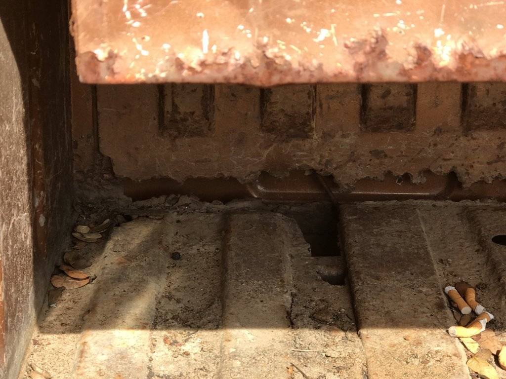

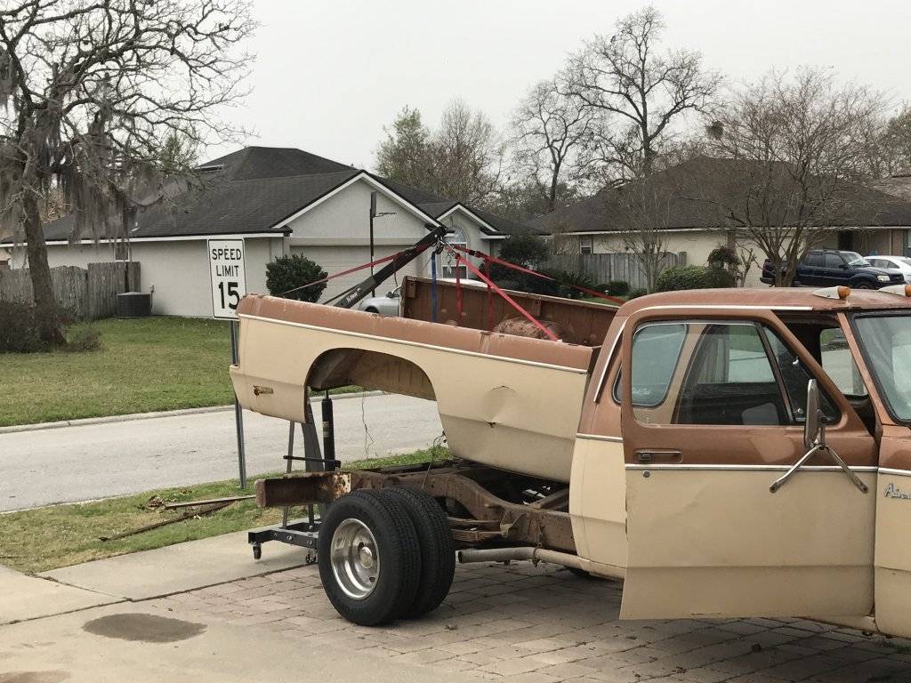

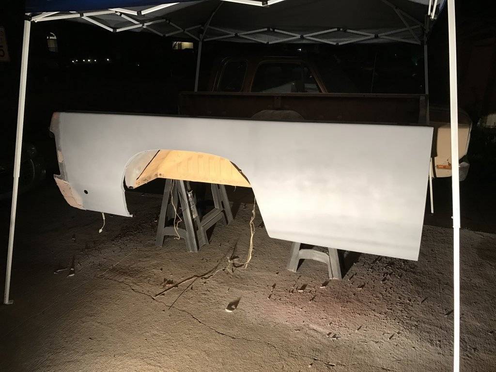

The old cherry picker came in handy today.
Got the front edge cut out, and getting replaced. Also persuaded the front top rail with the sledge hammer, and 2x4. It got bent in, and was touching the cab.
I'm not gonna spend a ton of time on this bed. Has a bunch of pin holes in the floor. Still solid, just not the best looking. Gonna treat with a rust concert or and paint. Then throw a mat over it to pretty it up. It has many years left, but if Sabrina wants down the road, we will find another bed to replace this one.
Has a bunch of holes up top from various CB whips, bed rails, and tool boxes. It was used as a truck lol. I'll get em welded up, and the outside looking purty.

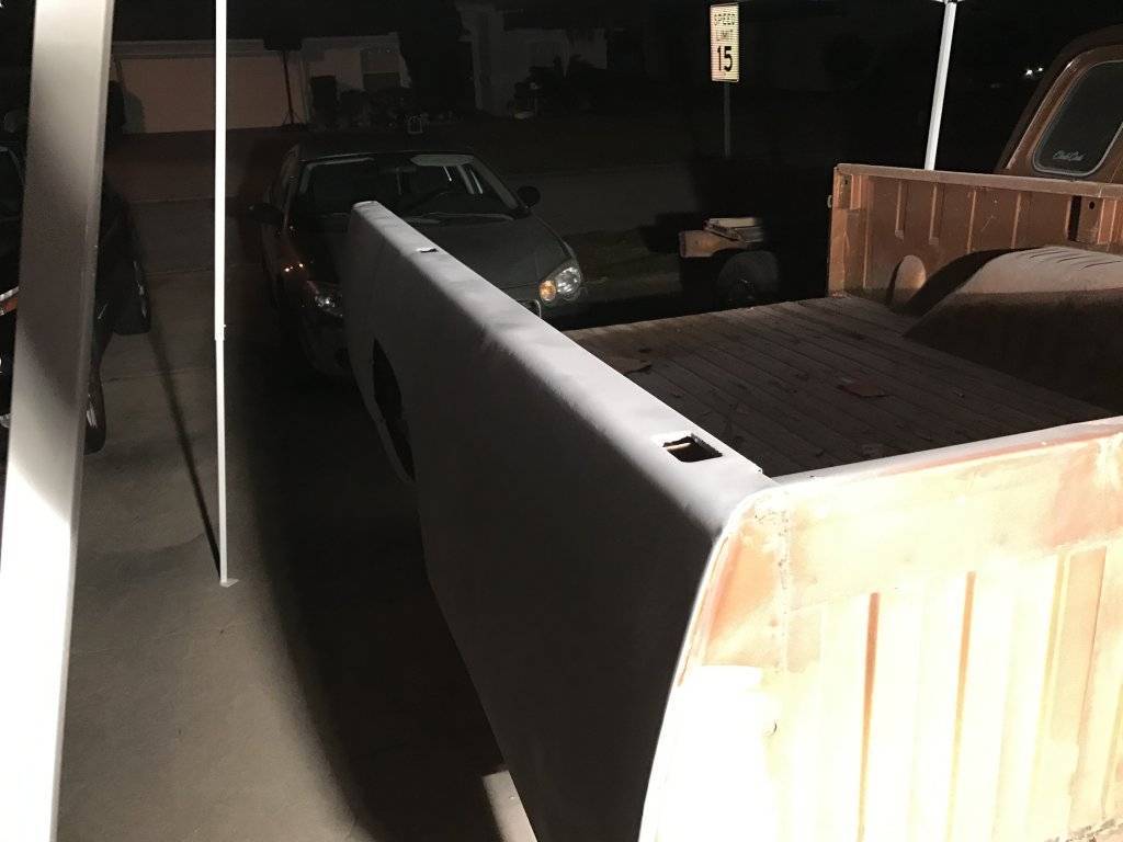

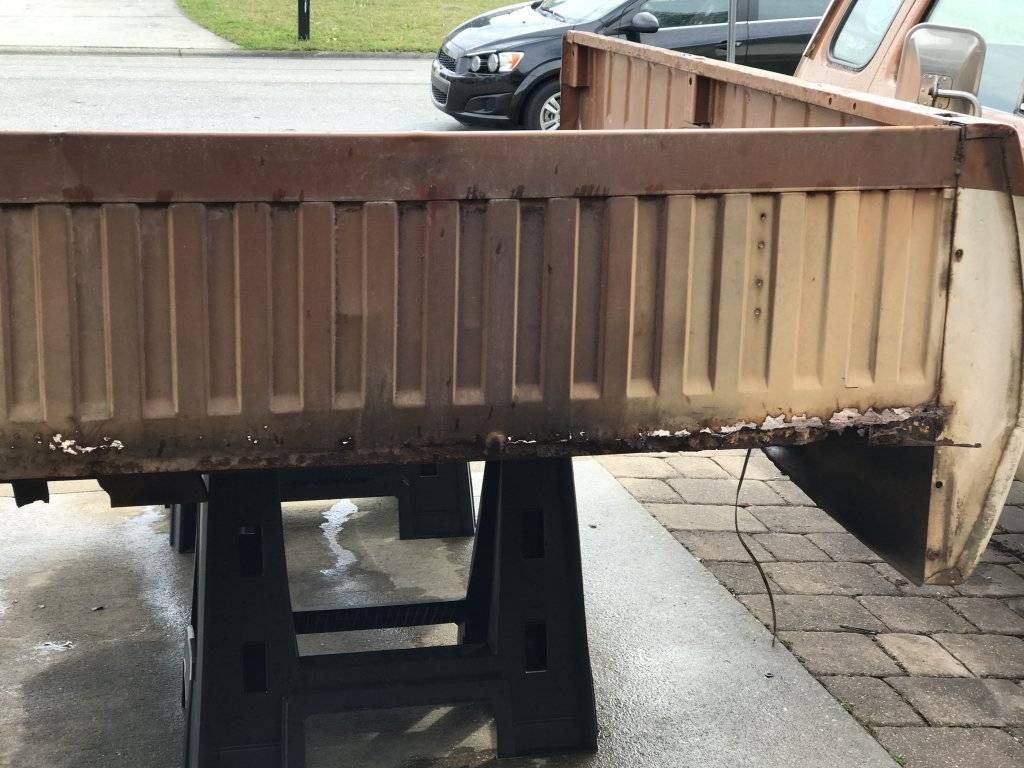

Been a busy weekend. Spent another 12 hours on her today. Had to run up to Wally World, and get one of those awnings to hide under front the sun. Was pretty bright/hot lol. Sucks not being inside the garage!

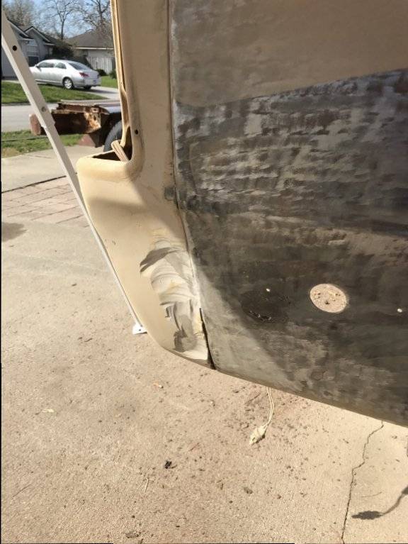

Got the bottom of the front wall welded up. Still have a couple pin holes to get. Also stripped the passenger side down, and got all the old paint/bonds off. Back corner behind the bumper was the worst. It's getting fixed the same way..
Also had a few pin holes towards the front bottom. I filled em up with that all metal. As I said before, I'm not going all out on this bed. Just getting it looking good as a daily driver for now.

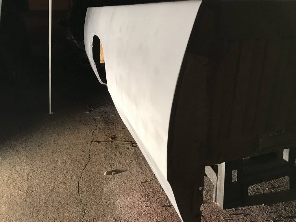

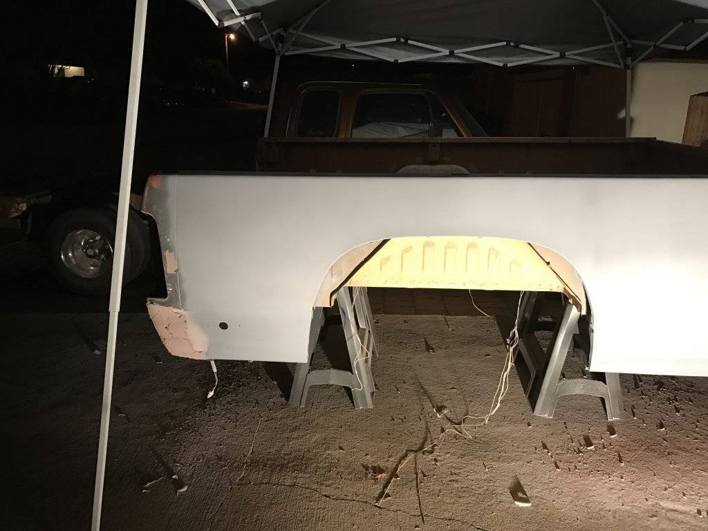

Also got all the holes up top filled with weld, then a coat of filler over. The best was getting the big *** dent in the side taking care of. Pulled out the old slide hammer, and took care of most of it. A couple coats of filler straightened it out. I'm very happy how it turned out. Still have to finish the rear of the panel, a couple more dents to fill, and spray some filler primer over it. Looking good though!
