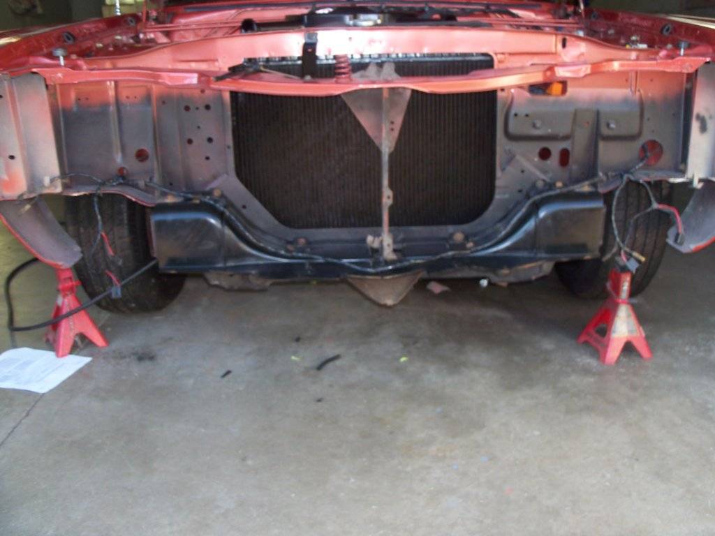

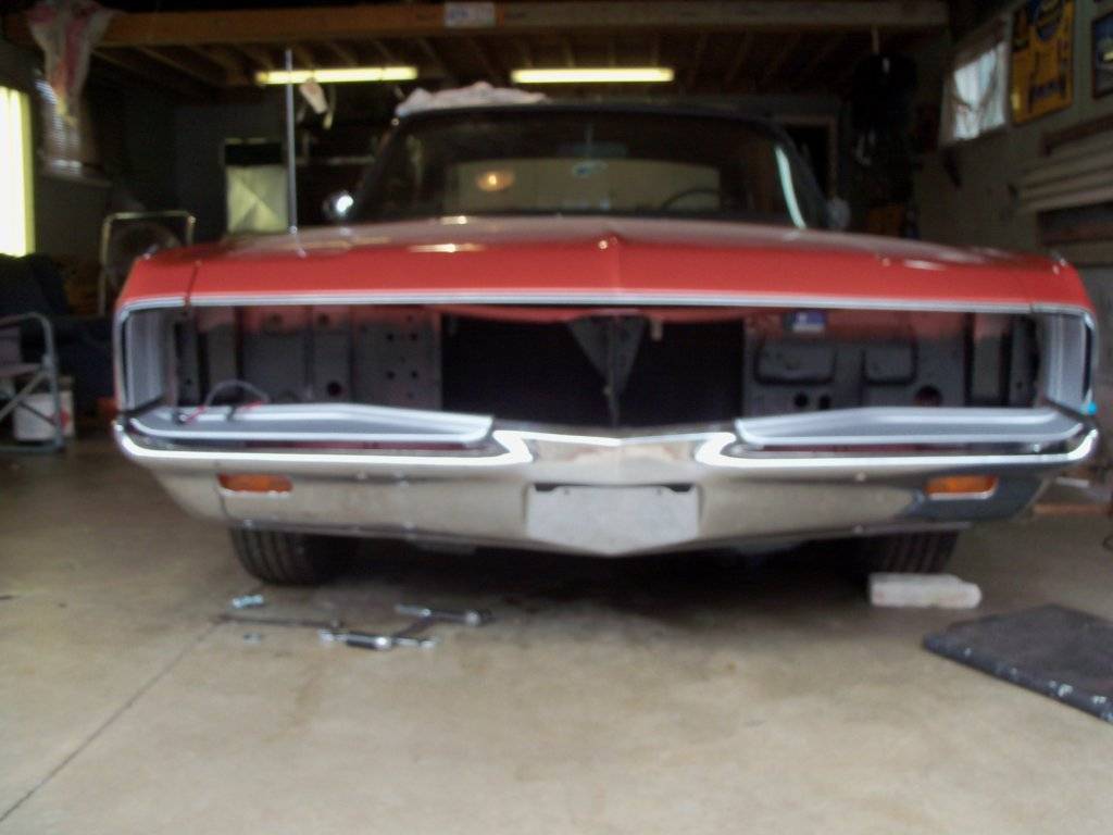

Great observation! Quicker than searching for unmolested, orig paint vehicles. Even if there might have been body color on all of the under hood body parts, there STILL was a semi-flat black that could appear on the front side of the core support, on either side of the radiator/condenser, so that "black" was seen through the grille, rather than body color. If you look at the spray pattern, it was not particularly taped/stenciled, but just quickly sprayed. I have seen some high $$$ restorations where this was not done, though. If you car had that from the factory, replicate it in the repaint.

I would guess light colored cars, if not all got a blacked out rad support cause I never recall seeing body color visible behind a grille when these cars were new.

Black,dark green,dark brown did not get the rad core support black out.
