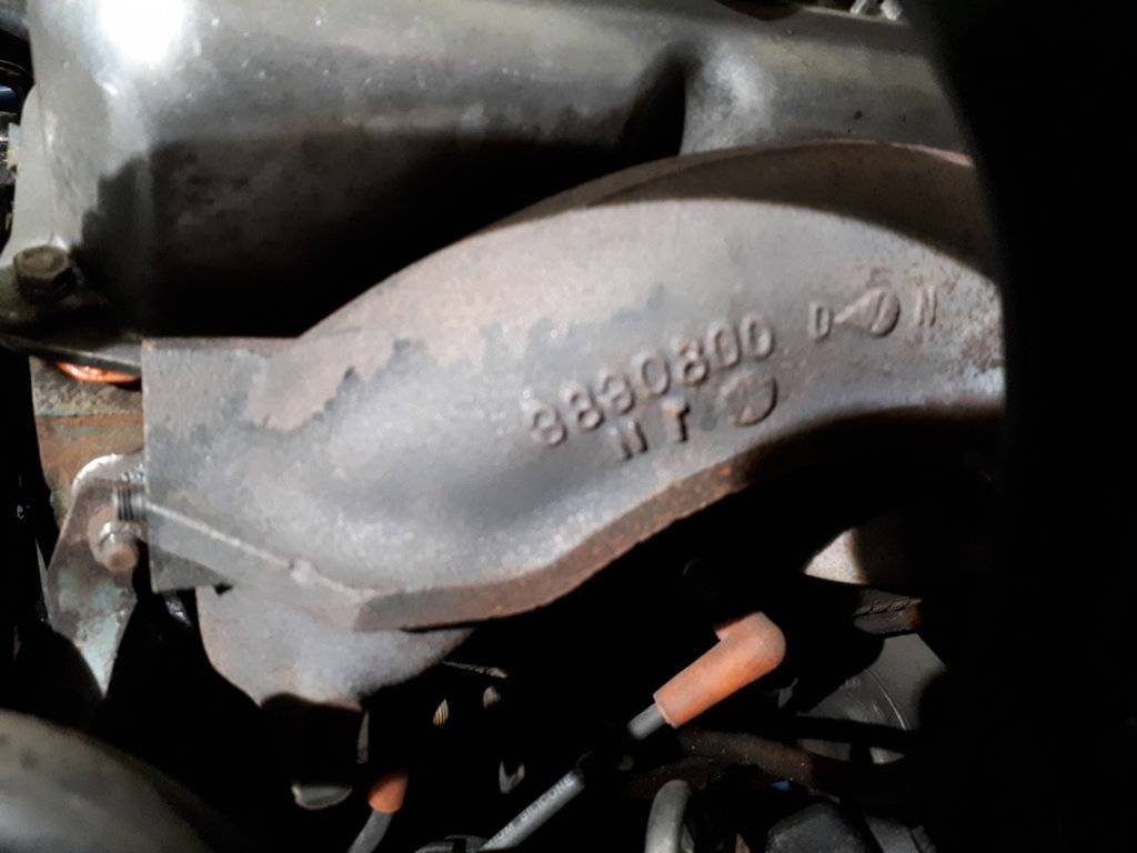

So I have a manifold number 3830800 on the left side. To what model it was installed originally and which casting number should be on the left manifold to get a passenger side HP manifold, which equals to the driver side unit flow-wise?
A tip: the engine is a 440 built in 67.

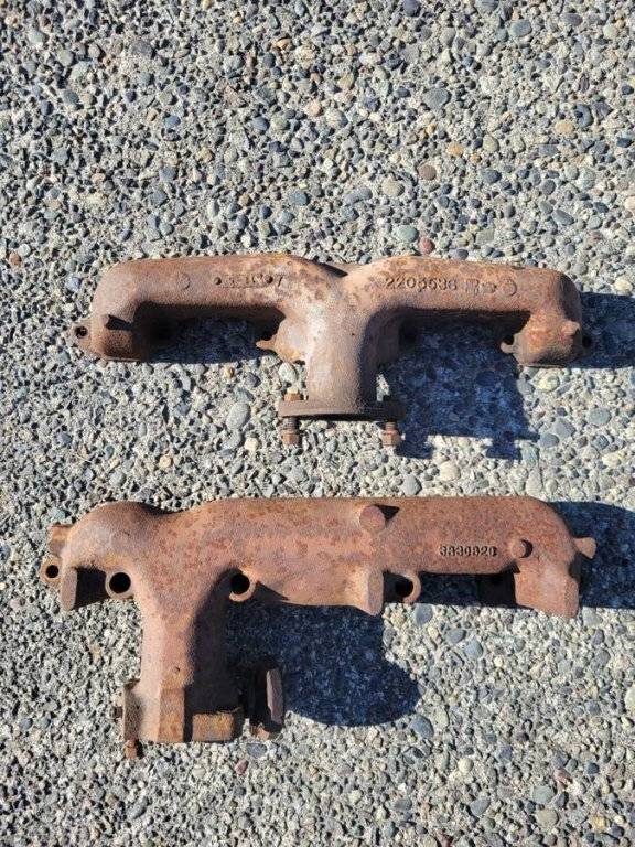

That one in the picture is a truck manifold from the mid 70's. I will check my pile and see if i have one that goes with it. I will have to check tomorrow though. This is the number needed for the other side, 3830820 - Right
