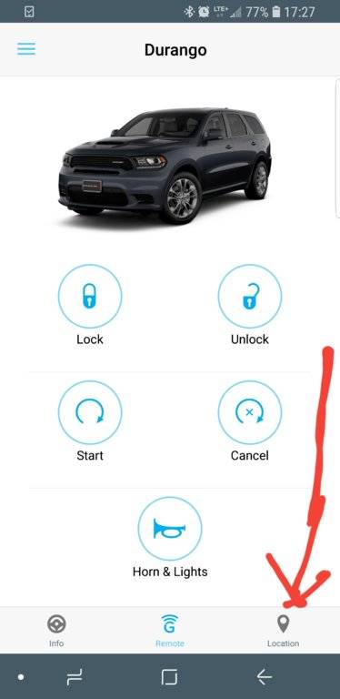

There is a system on the car that I can call to unlock the doors. Maybe they can kill the power to the car if I report it stolen. They are suppose to be able to send help to my location so they must have a factory system onboard to tell where the current location is. They already send me a monthly report on what the air pressure in the tires are and whether the engine or transmission needs any kind of service.
If you have the app that is telling you your mileage, tire pressure, oil life, etc., there is already a locate my car tab.
Both of my vehicles have that.
I'm going to sign up for that service.
