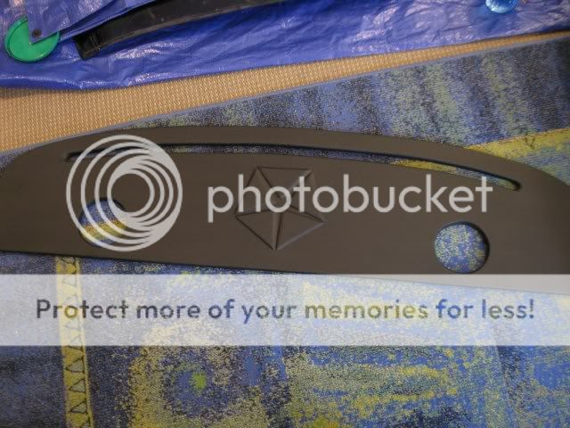

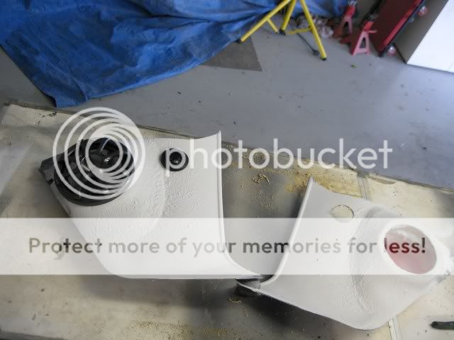

We are running Kicker gear in the fury, while not "top of the line" stuff, it is very good sound for the $$ paid.
we run 4 x 6inch component speakers with splitters and a 12inch square sub, running off a 700w 5 channel amp, it runs off a JVC mp3 headunit sitting in the glove box.
Front speakers are set in an old set of kick panels, I fibreglassed some plastic buckets and mdf rings to the panel to take the speakers, rear speakers are set in a custom mdf parcel shelf
sub is set in a mdf box with the amp, the box also covers up the airbag compressor and takn, for a tidy trunk
Sounds good, loud enough to hear over the big block
