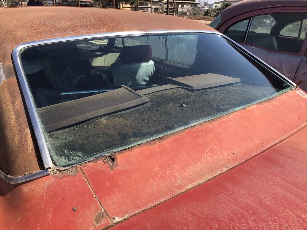

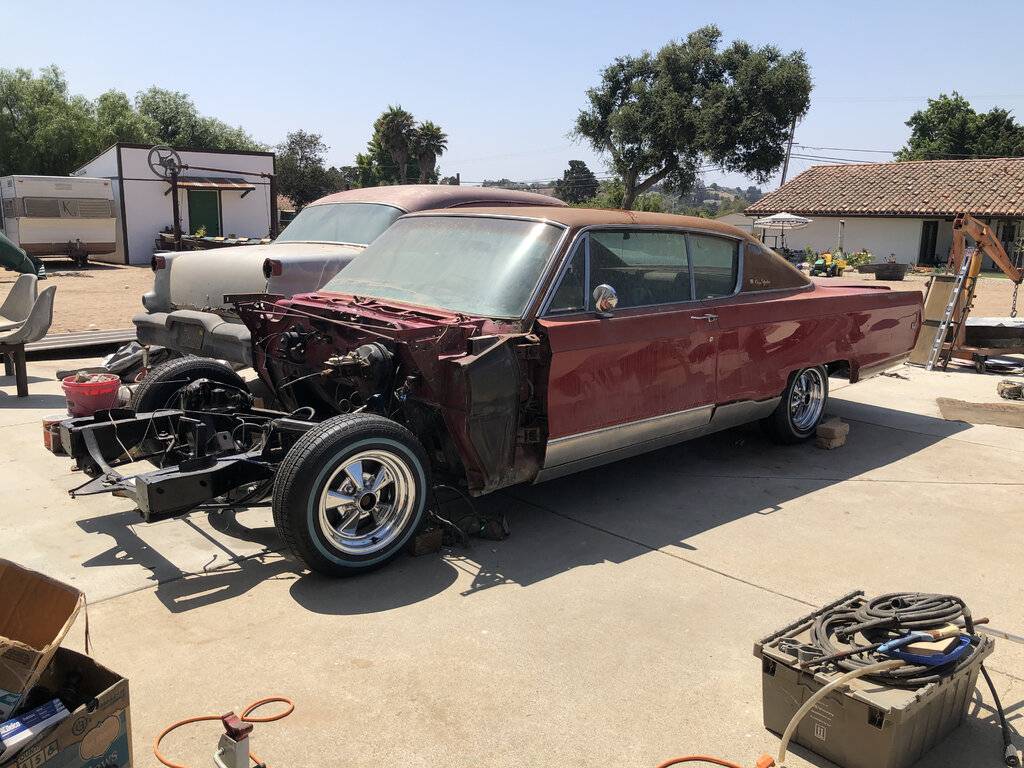

Moving along slowly but surely in my backyard build - reviving a long abandoned ‘68 New Yorker. Tomorrow Apex Auto Glass is sending techs to remove the front and rear windshield/ glass on my 2 door fast top. They are solid and in tact - BUT, in the event that they break… is there a source for new glass? I’m mainly concerned for the rear window! I would appreciate any input.
Rear window is not available new, but it's glued in and pretty easy to get out. Also, since it's tempered glass, it's much stronger than the front windshield.

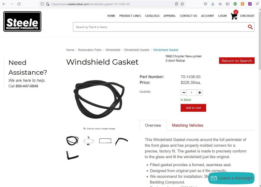

Front is a different story. Any small defect like a rock chip or deep scratch will make the glass very fragile. It's gasketed in. The best way to remove it is to cut the gasket. Reproduction gaskets are available. It's also easier to remove the trim if you cut out the gasket first. Front windshield is available new, but they are expensive. They were around $750 before Covid, so wouldn't be surprised if they are over a grand now.

Might let the glass company do the acquiring of the windshield, if needed. Might cost a little more to do it that way, but that way, THEY know what is going on and can coordinate getting it and getting it installed. With the new gasket you provide, or perhaps they have a source on those too? In any event, the more things they can supply AND warranty, if needed, the better things can be on your side of the deal.

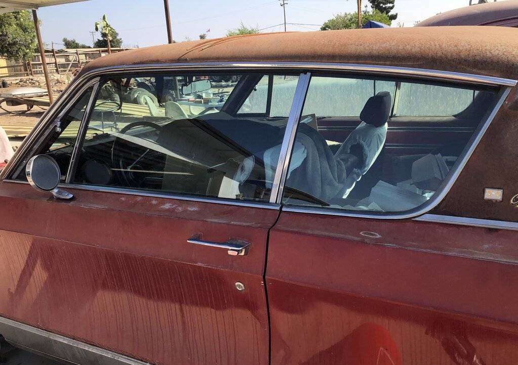

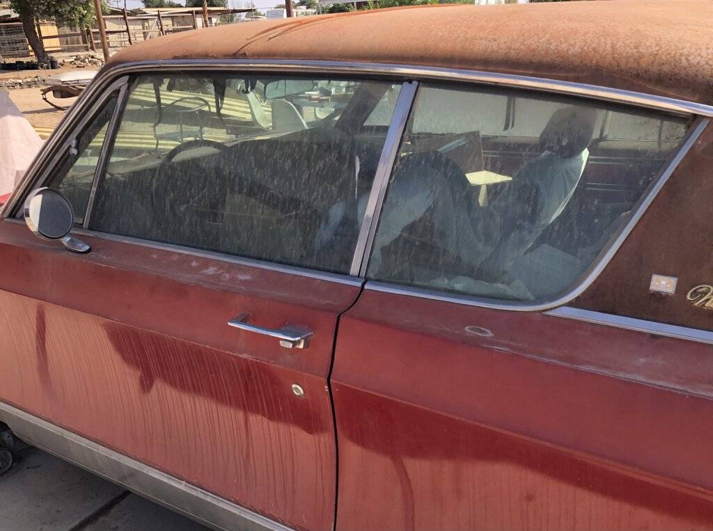

I did a clean up of the windows. Poor old sweetheart hasn’t been cleaned up in decades. I sure haven’t cleaned them in the time I’ve owned it. Made a big difference! All I did was dilute vinegar and water and used some lint free towels to wipe them off. Of course I blasted them off with water first too… Super happy with the results! Now I’m just imaging how it will look when the new metal is welded in and the roof is a complete and solid unit once more… then the roof will be painted and I’ll give the car a complete detail (Foam bath, clay bar, wet sand, buff and polish and ceramic coat.) Not too far away now :)
BEFORE
AFTER!
I should see if Murray has some scratch free side windows. Mine are pretty hazy. Yours look great.
