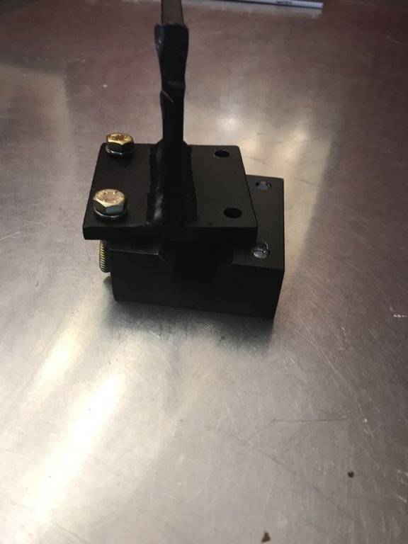

    I have read through a few of the "torsion" bar threads on how to remove stubborn bars, but I have a real stubborn one. The stub frame is out of the car and I have the tool from American Muscle, so I have the room to really wack it. It's moved only about "1/8.
    The rear clip is out and the LCA spindle nut is off. The LCA is loose, no tension anywhere. I have pried the LCA back, as some threads suggest, but nothing. Does anyone have any suggestions?
    I sheared the bolts off the tool too.

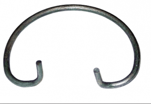

    Did you remove the rear torsion bar clip?
  5. KJoeZ61
    KJoeZ61 New Member
    Messages:
    35
    Likes Received:
    6
    Joined:
    Mar 29, 2015
    Location:
    Northampton Pennsylvania
    The on that the rear of the bar sits into the frame.

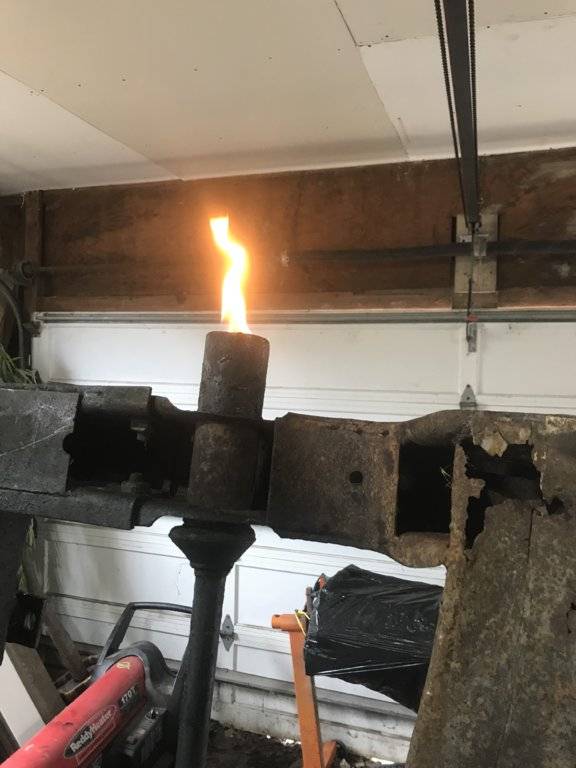

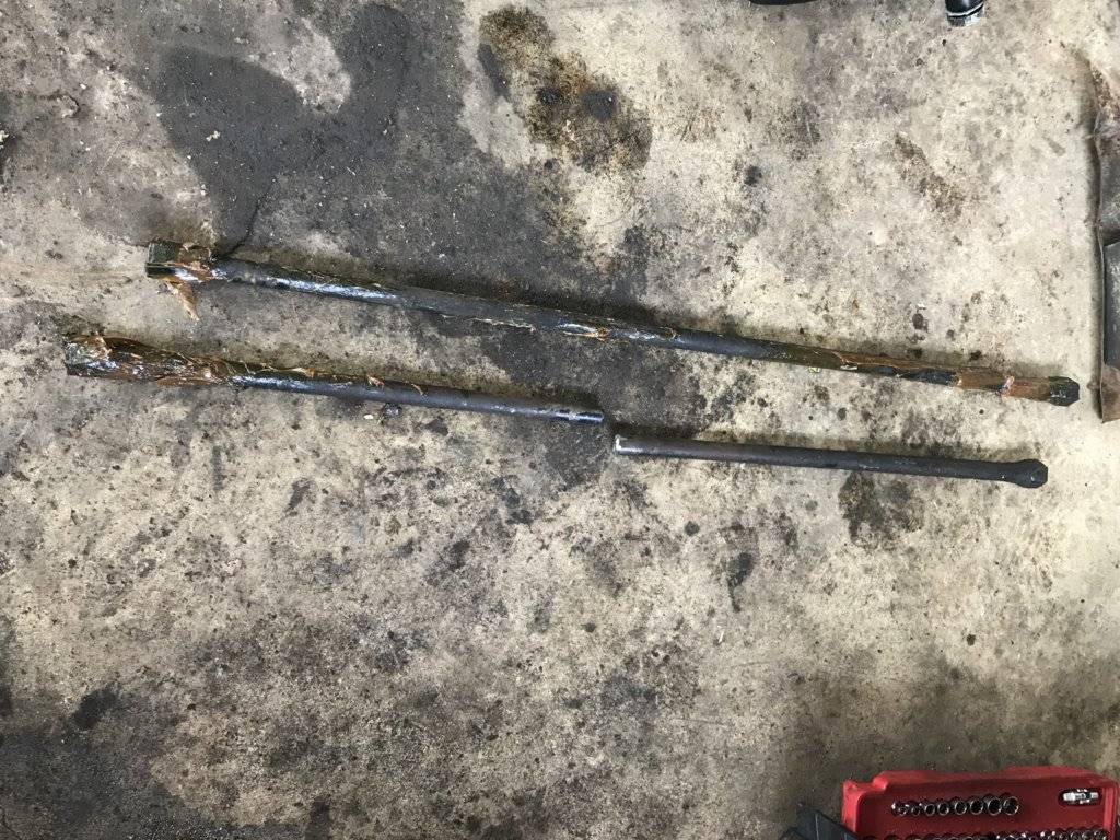

    It was pure will against evil:
    Using acetone and penetrant did not work (even lighting acetone on fire did not work) The OEM tool did not work. Prying the LCA did not work.
    So, I had to cut one of the bars. I call it a draw. One saved and one cut.
