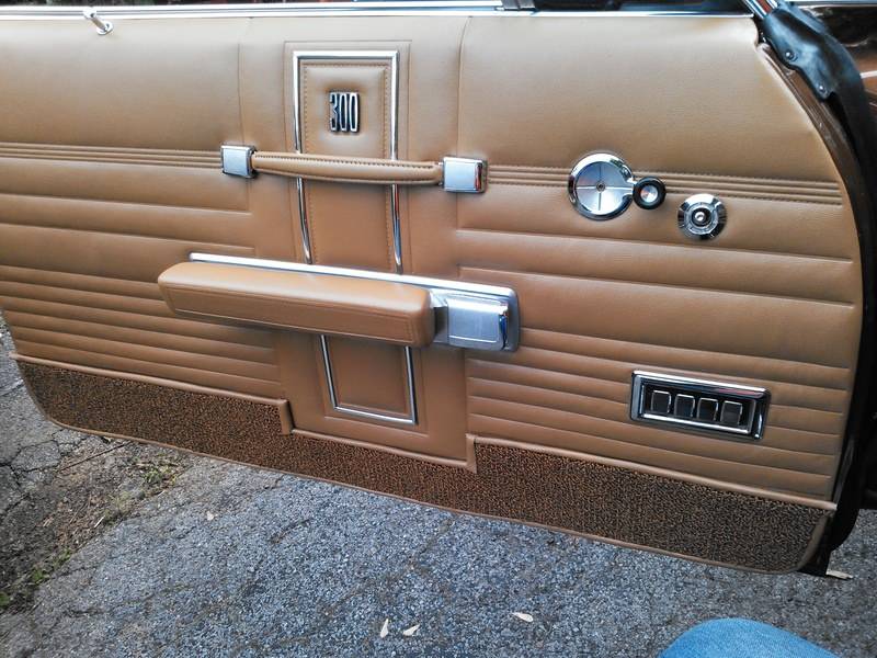

Mine before and after refinishing.

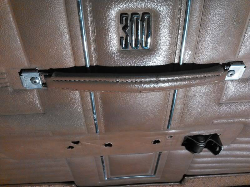

I've got the headrest dark fade on the top outside edges in my light tan interior . Not sure what color it's called. A lot lighter than that 300 b4 & after pic (beautiful by the way).

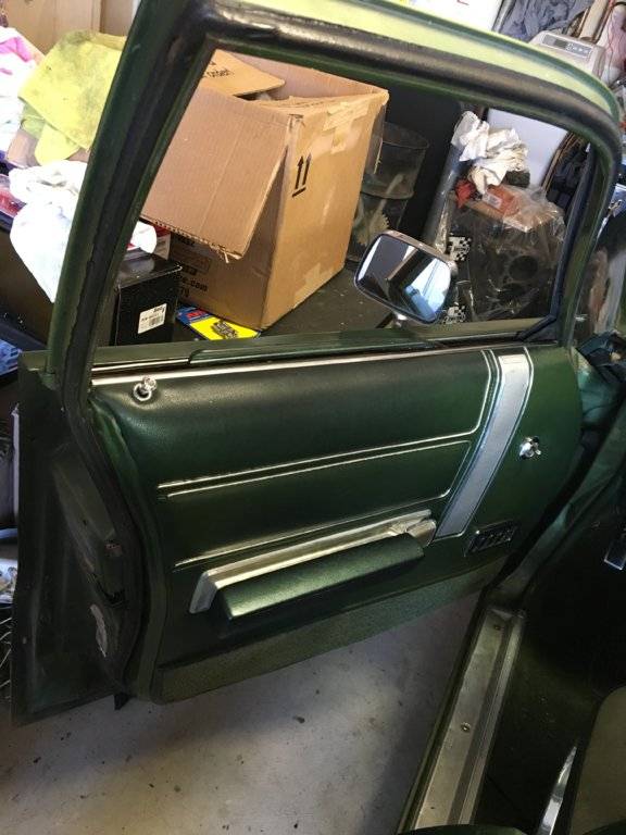

Thanks for the tip. My door panel has TWO different colors butted up to one another. Could I do a panel like this by masking?
I don't see why not.
Use some good masking tape like 3M Fine Line and not cheap paper masking tape.
