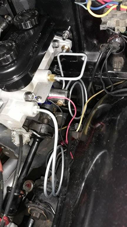

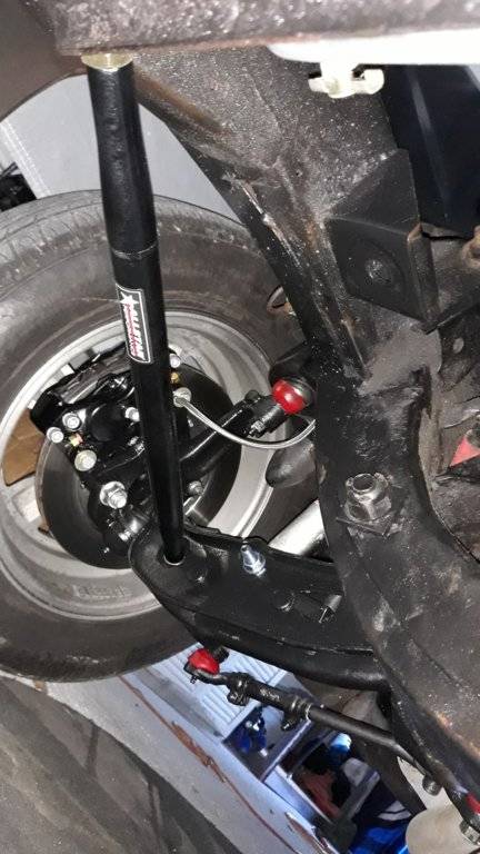

Just a follow up on the install.
Everything went together well. The kit is good quality.
The only thing that really didn't seem perfect was the routing of the flexible brake lines. Coming up out of the caliper they were only a couple inches from the rotating tire. Maybe it is nit-picking, but I felt better about giving the lines a new route.
The local hydraulic shop had a couple of 90s that pointed them away from the tires.
After driving around a while and bedding in the pads, I got up to 80 and did some panic stops. The car stopped quite nicely with zero lockup. I did not use a proportioning valve, only a 10lb residual valve for the rears.
The recommendation of Wilwood was to use the 1 1/8" bore. I almost did not listen to them and was going to the 1 1/32" bore, reason being the new calipers have less volume than the Mopar
single pistons. I actually ordered their recommendation by mistake from my bookmarks after a long shift at work.

The pedal has plenty of feel, goes down about half way under hard braking. I went with a Jeg's house brand, as it has mounting holes for the line-loc. That bracket is one of the best $40 parts I've bought.
JEGS 631455: Stage Control II Valve Mounting Kit For JEGS Master Cylinders (See More info/Details) | JEGS

Nice, glad to hear it went together well, and performs well.

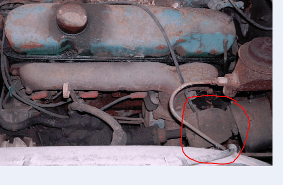

Now, not to be nit-picky, but PLEASE, for your safety and that of your passengers and others on the road with you, GET A HEAT SHIELD ON THAT RUBBER COUPLER on your steering column. Your exhaust manifold/header will COOK that thing, it will fail, and voila, next to no steering except for the 4 allen head bolts, which will allow almost a full turn of the wheel before they'd grab and turn the input shaft to the box.
I know the shield is a PITA to get on and off, but the safety outweighs the convenience. Plus you can slot the holes in the shield and just loosen the screws and slide it on and off.
Get a shield on that thing! :)

I guess I was unaware there was a heat shield, my car never had one since I owned it? you wouldn't have a pic of one by chance?
Only pic I have at the moment, it's the booger next to the column shift box.
