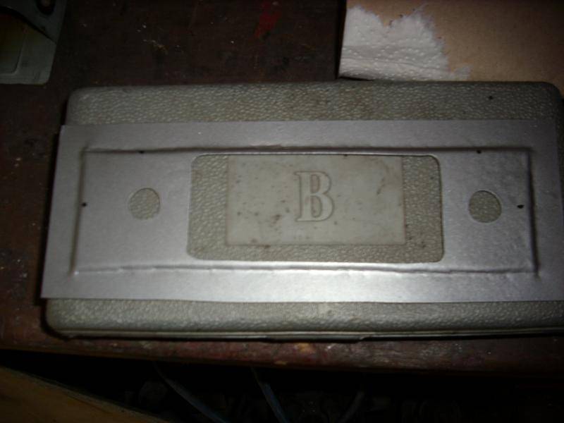

We seem to be dealing with the same chit these days. I'm doing exactly the same, however on a way simpler one piece pressed steel dashboard of a German middle class car. Just fabricated an offset metal plate which I'm going to glue to the hacked up area to avoid burning up the original paint by welds and put an original radio with proper chrome cover plate over it which will cover the whole mess.

I'm going to use a two component adhesive in my case, which is usually used professionally for metal/aluminum window frames in housing; it's supposed to be as tight as welding. A friend of mine who works in this business is supposed to drop off the stuff today at my home.

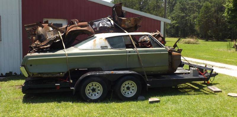

The carcass that it comes out of has to be going to the crusher next,
Hmmm. The's a drastic thing for you to do. An unhacked dash is priceless to the right person.
I'll let you rethink that over the weekend.
That car was crushed long ago.
