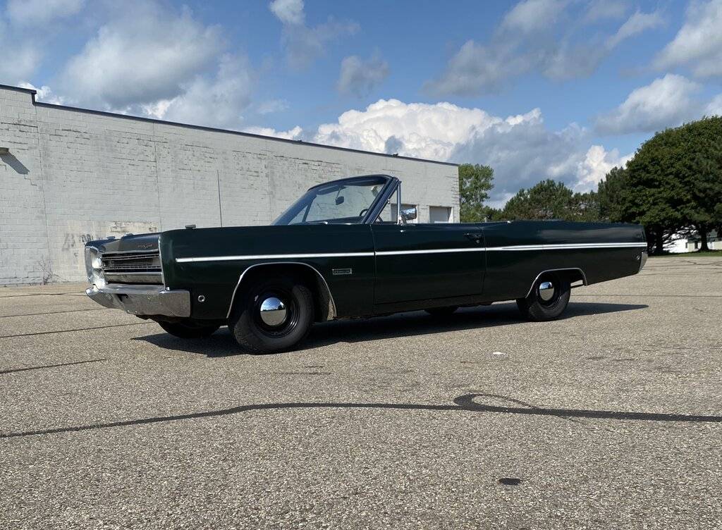

    My new to me 68 Fury III Convertible is in really great shape other than the drivers side seat and the convertible top. I know that if I pay someone to do both I’m probably looking at least $2k for parts and labor. I’m a DIY guy and have built and worked on motorcycles professionally for almost 20 years. This is my first venture into the classic car world though. Have any of you ever done your own convertible top replacement? The frame is all there and the mechanical stuff all works fine, it’s really just the canvas and the well liner that needs replaced. (Plus a little sheet metal work on the front bow which I know I can fix.) Any advice? Any pictures or tutorials? It definitely looks like a huge pain in the butt but I think I wanna try it myself. I’ve searched the forum and didn’t come across anything. Thanks, D.J.

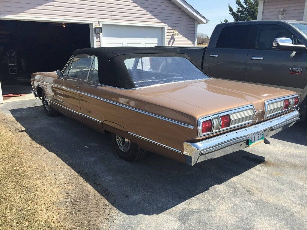

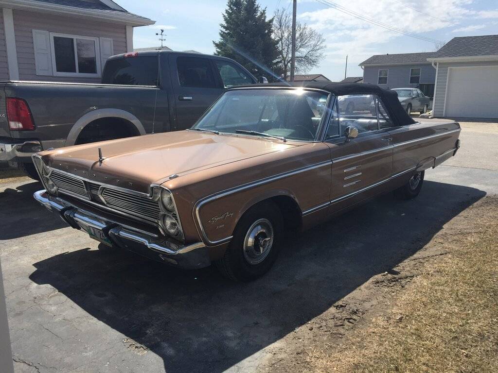

    I did my own but did lots of research first. My biggest advice is to check that the frame is working correctly and aligned properly before you start. I realized after I completed mine I have a slight twist in the frame. It’s not a big deal but I need to revisit it in order to get the windows to seal properly. The instructions you receive with the top are generic but still apply quite well. I got mine from convertible top guys and am happy with it. Also take lots of pics when you take it apart for reference.

    Yes it is a canvas style material. Very pleased with it.

    Need more pics and details about this beauty

    Great looking car BTW! Good luck!
