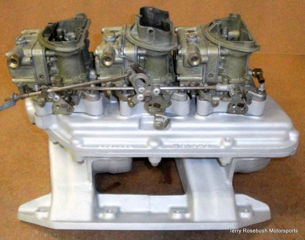

I just picked this up, wondering if anyone has experience running this setup:
It's going in my Dart sometime down the road and if possible I would like to use it for street and track use, mostly street use around my local area as a track is 2 1/2 hours away and I don't have a trailer. In have plenty of time to get parts and info. I have the Mopar Engines book for a basic recipe for the engine build, but if anyone has any info that might help.me.out, feel free to let me know. Thanks.

It's set up for drag racing basically. I could add vacuum secondaries for the outboard carb, etc for street use. Luckily I know a guy who owns a Six Barrel car and has plenty of experience with them, so I can get it tuned fairly well close to home. Without him I'd be a bit more pessimistic. It will sit for a while, til I can build a proper engine.
I ran a six barrel setup on a couple different cars for many years.
IMHO, while I don't know what the rest of your combination is, I don't think you'll be happy with that setup. The big, single plenum and short runners aren't going to have the low and mid range power that you need to go fast on the street... and then you have the mechanical linkage with accelerator pumps on all three carbs. Again, not a real great street package.
IIRC, Chrysler had a number of mods for the plenum for that manifold to keep gas from puddling. When they first were produced, the manifold was aimed at the six barrel cars running super stock class. As it turned out, it wasn't very popular. I remember one car being half successful, but they were "tight" with Chrysler and there was other factors making them fast.
If you want a six barrel setup, go for it... but sell this one and get a dual plane manifold and some vacuum secondary carbs. You will go faster.

That is THE tunnel ram intake for a 440. The only shortcoming it has is the lack of a 2x4 top.
Runner length is ideal for the RPM range a 440 is suited to.
You will never find a dyno sheet that supports the misconception that a TR won't work on the street.
Those intakes get north of $1000 bare, no carbs.
Don Dulmage has an article on his site about making a 2x4 top for one. It's a good read. Lots of good info on his site.

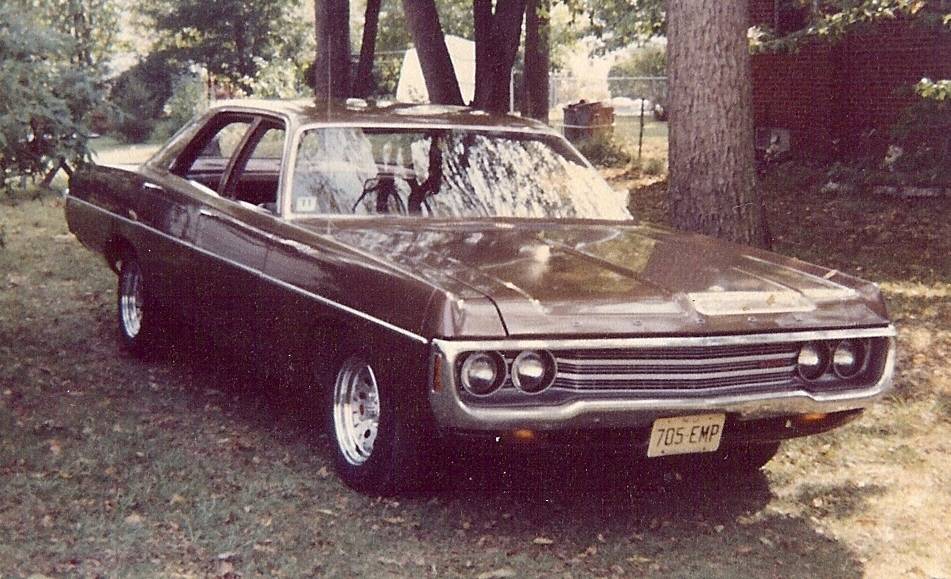

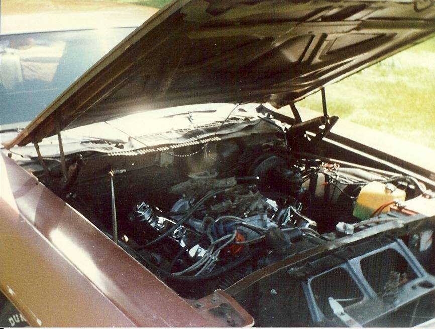

Damn, I dont know if I ever knew. After I pulled my 318 in favor of a 340 from a duster I sold that and went to a 400 from a 69 Polara. I thought it was a 383 when I bought it. The 400 Turned out to be a 1972 400HP block that I ran the snot out of. One day that 400 started to shake, rattle and sputtered to the side of the road.
I took the car to Tom Chamberlain in Mt Ephraim. Old Tom was a very reputable Mopar guy and engine/transmission builder. I told him I wanted a 440 built with 3 2s. He said ok. It would cost me a grand and he gets to keep the 400. I have no idea what he did to the inside of that engine or how it was built. It was fun and pulled ok but not what I had hoped for. I eventually traded the 3 -2s for a Thermoquad and a brake job.
Then that engine went to racer Dom Balducci and he sent it to Radar corporation for a complete re build. 12.5 to 1 compression, 292 duration with a 510 lift on the cam. They did $900 of head work, remember this is 1988. Dom encouraged me to sell the C body and buy a Dart or a Challenger and promised if I did he would have the car running 10s . I didnt want that , I wanted a tough C body. Knowing me he kept it "detuned" . I had a reputation of breaking engine mounts, universal joints and trashing transmissions. ......
