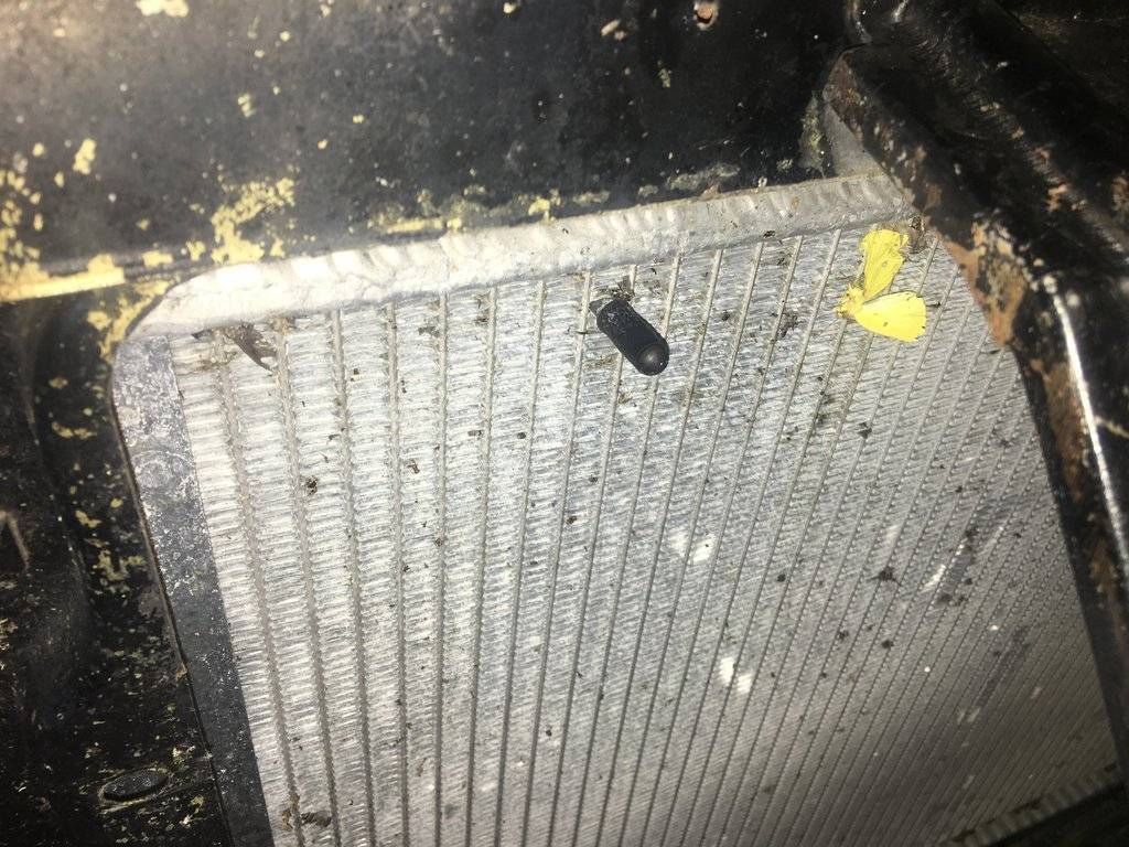

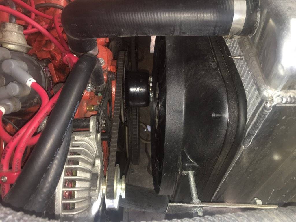

I installed a 15" flex a lite thermostatically controlled electric fan . It comes complete with mounting brackets and the shroud. Hands down was the best move I made for cooling my car . I can be in the middle of the city in August in a traffic jam for an hour and my car will not heat. The thermocouple pushes into the rad fins just below the top hose and I mounted the control dial on the rad support. I have it set to turn on the same time my thermostat opens 185 F . I used a hand held infra red hand held thermometer to set everything so I know exactly where the temp is. The fan doesn't run when I'm driving down the hyway only when I'm cruising around town or at stop lights and such . That being said I do not have air conditioning but I don't think that would be an issue. I removed my 7 blade fan and installed the fan in one Saturday and was cruising around that night. The one big piece of advice I can give is get your self a Infrared thermometer it will be a huge help to you when setting the thermostat fan control. Oh ya and a case of beer !

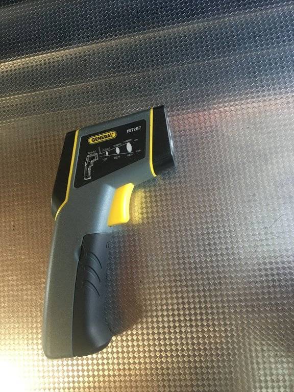

This Little tool will tell you exactly what temp your motor , water pump,rad or what cylinder isn't firing properly just by pointing it at the exhaust manifold and pulling the trigger. It has saved me countless hours of work on my motor when troubleshooting heating issues and their cheap to buy .

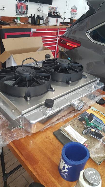

Dual fan assembly used in new challengers is just great! I have one in my old challenger and it fit there with some trimming on the shroud. I have aftermarket radiator but I made some quick checking and it should be decent install at least into fuselage cbodies too.
Also those fan assemblies are dirt cheap. Only problem is that if you are going to run both fans, I would suggest some charging circuit upgrades

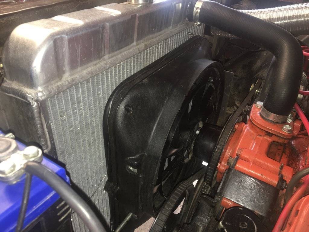

It is surprising it works well for you since it looks like the shroud only covers about 3/4 of your radiator surface. Your radiator looks like an aluminum aftermarket one. Was it larger than the original?
Was there a reason you put if off to one side of the radiator, rather than in the center? Also, I do not understand why you need the infrared gun, if you set the fan thermostat to the rated temperature of your engine thermostat.

I just mounted it like that only because that’s where it worked out the best for me . For my car it works very well for cooling In stop and go cruising and traffic jams . This particular fan is the high out put, low noise ( curved blades) set up. The fan shuts off when you are Highway cruising and the air flows freely unobstructed through the rad. I found out the hard way after making my own home made shroud , that you can actually hinder the flow of air though the rad and then it will heat while highway driving. I had used a 1/8 sheet of aluminum made to fit the back of my rad with a hole cut to match the size of my fan. What I quickly found out was my aluminum shroud was actually causing an air dam and would not let the air flow through the rad when highway cruising. 10 minutes later I removed the home made shroud and mounted the fan as you see it and it’s worked flawlessly ever since
