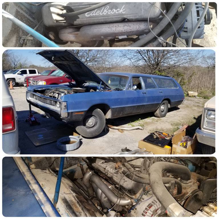

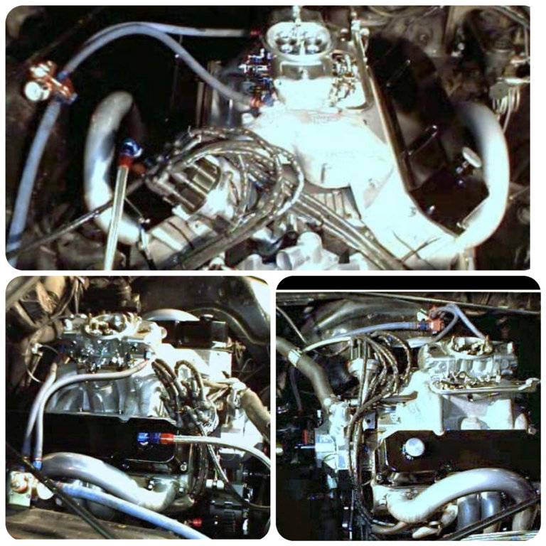

*Pictures: Blue Wagon TTI header install. Black Fury custom headers built in 1998 before TTI was available for Cbodies.
