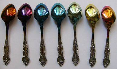

I'm in no way an expert but I did a quick search and came up with this. Apparently stainless can be anodized.
Anodizing of stainless steel
okay maybe I have to add "diy on your balcony" lol. Regular steel no problem and I know that there is a stainless "blackener" however, i do t know if that gived a black oxide finish or what!?

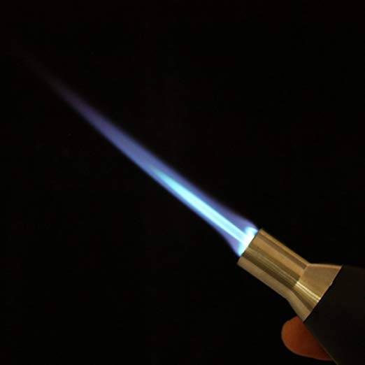

I saw the torch methods already, not consistent enough and would give more of a color case hardened look!?
I understand you can color polished 304 SS with an immersion in a hot acid bath, but it's nothing that you can do at home.
