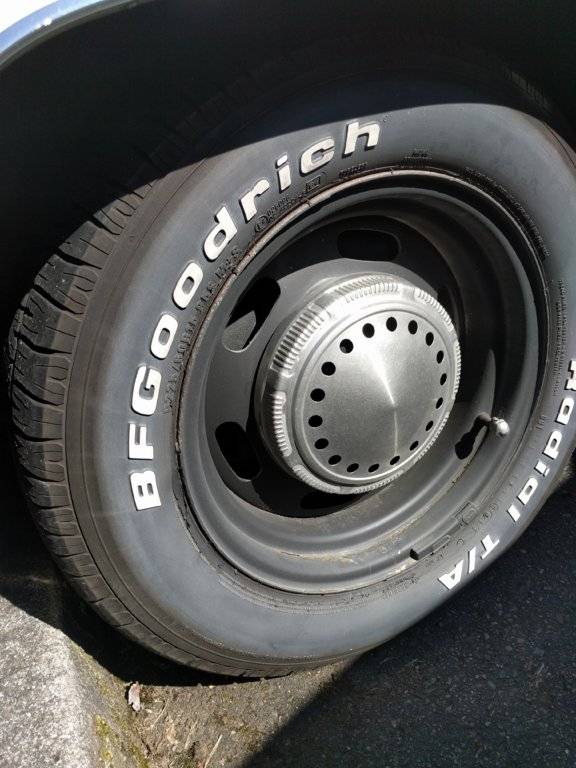

Anyone knows what causes this on BFGs?

I noticed this on my tires a while ago, anyone knows why part of the sidewall discolors like that? They are about 4 years old,all 4 do it, one on the rear i see some... "Cracking" already where the lighter and darker area meet. When they were new, after 3mo i had one tire replaced cause there was a credit card sized gap where the two areas meet all around the tire,like it was precisely cut!? I dont use any product on them, should I?
Garaged for 2, then covered for 1 1/2... Idk If they are repop. They dont have many miles on them, couple thousand maybe
Cracking on the sidewall is never a good sign, usually means that there is a problem with the sidewall belts. Sidewalls take up most of the flexing when the tire is distorted from turning. If the tire construction is failing, the sidewall belt can start to "walk" which causes the rubber covering over the belts to get cracks from excessive movement.

I think they are actually BFG. When I had the warranty claim on the first tire with the split in it they gave me fuzz about that its not an issue and not covered under warranty. They replaced it for free when I asked if they will be liable when this tire goes out going 55. I am just wondering, since they have low mileage on them, is this a concern/warranty worthy? And can I do something to get rid of the discoloration? The cracking is on the drivers side rear.
You have nothing to lose by asking.

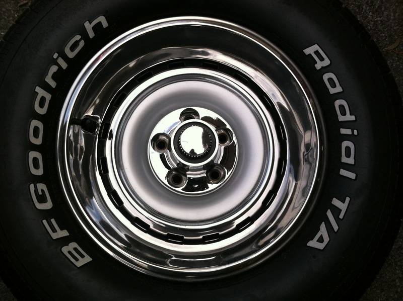

Not a great pic, I was concentrating on the wheel, but my BFG tires are a nice satin black. These are far from new tires.
Not a great pic, I was concentrating on the wheel, but my BFG tires are a nice satin black. These are far from new tires. View attachment 174912
Thank you! And very interesting, you can see the difference in the rubber in that Pic too! Yeah I actually have used the Bleach white before... even stripped the paint of the rims :wtf:
I'm wondering if it might have to do with atmospheric ozone?

That color change is not really a "quality of workmanship" warrantiable issue, to me. If the tire store does warranty it, knowing that when THEY turn it in for warranty to BFG, they'll get dinged for it.
Tires are composed of several different rubber compounds, depending upon which part of the tire it is. I suspect that's what you're seeing, graphically, with the "brown" area. Different rubber compounds.
I'd say clean them up and put some "tire black" or other type of coating on them, Make them look nice. As long as they don't lose air, drive reasonably smooth (with good balance), and don't have any cracks between the tread ribs, then you'll probably not have any problems with them.
DO verify the production date of the tires! This will be an indication of "tire age". Anything approaching 6 years old should probably be replaced, no matter how much tread is on them. You can use them as "roll-around" tires, though, but NOT for use on the public streets or highways.
