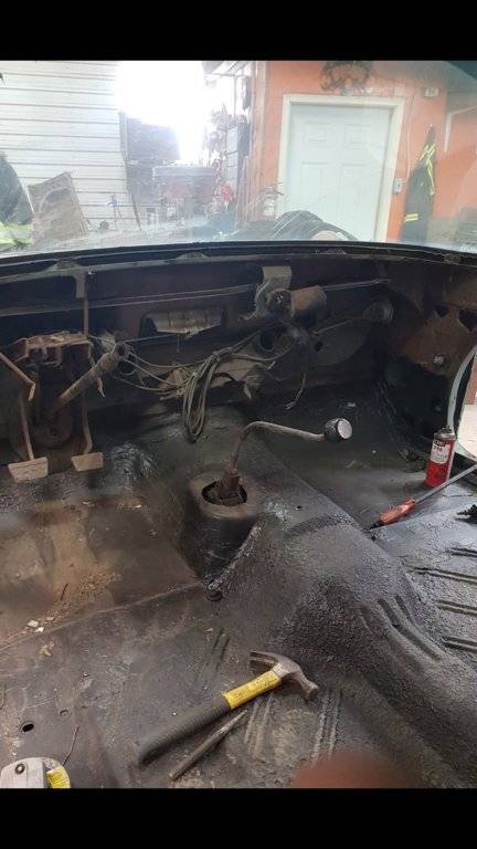

I’m trying to fix the dash lights of which 0 are working. It was a nightmare to replace the headlight switch and even trying to find all the lights from below will be near impossible.
Anyone have any ideas on taking pieces off to get in behind?

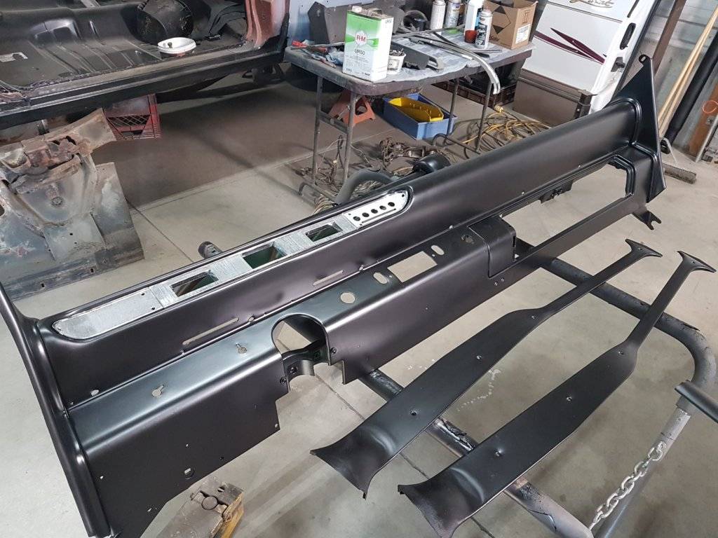

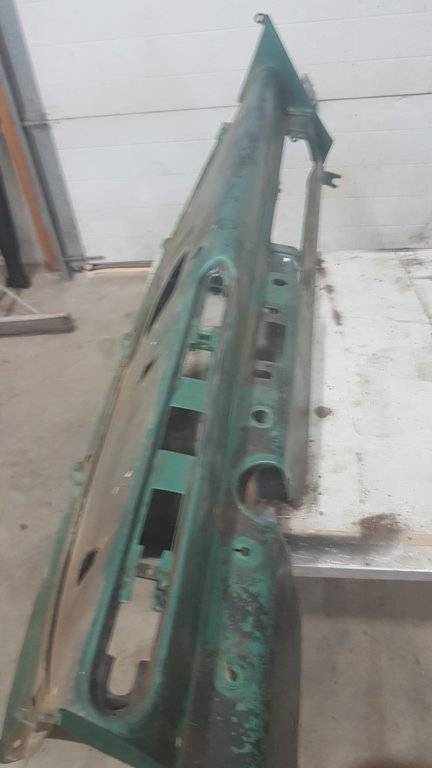

I took my 61 dash, (very similar), Out of the car with the harness attached. Repaired and replaced everything. I have yet to reinstall it though. You need a second set of hands for that.
Take pictures of everything.

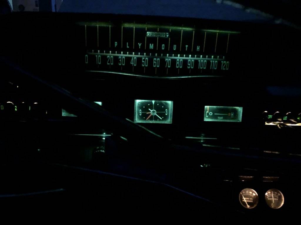

I dont know what's up with mine, they are powered thru the key switch...key on, dashlites on! Dont know, previous owner must have done it and I ain't messing with it. Here is a couple of pics that may help you along
I like that. One big piece. looks like you drop the steering column and unbolt it at either end. One could then reach down from the top and disco everything
