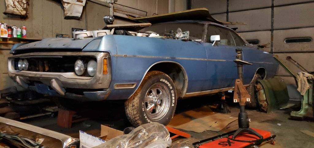

I use cribbing blocks if i need extra height. Floor jack to get them under there.
Edit: There are some excellent solid rubber ones that don't tend to creep forward, and are easily able to withstand the weight of a C body. Plastic I don't like - as indicated by Mike below. The modern sheet metal ones I wouldn't go underneath ever. Too flimsy. The old vintage ones were much better, but the ones I like best are the rubber ones such as the ones Mike linked below:

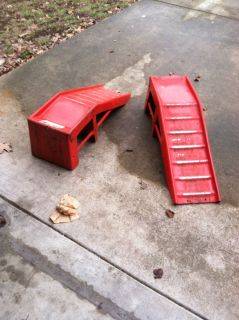

The ones I posted last night I though were rubber, but they're plastic, and I wouldn't trust them either.

Not sure what brand or store these were gotten at...been holding up C bodies as well as other Mopars for the last 20 years. Maybe longer.

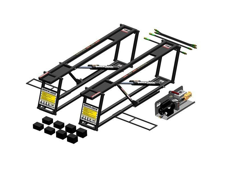

Anyone here have any experience with the quickjack system? Hate bugging my buddy to use his car lift at his shop for little stuff that I could do at home. I am sick of jack stands.

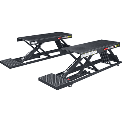

These scare the hell out of me. Dont have the height in my garage anyways.
Those are interesting too. You would be hard pressed to get under there with a creeper. Although these look good too that were on that link you posted.
